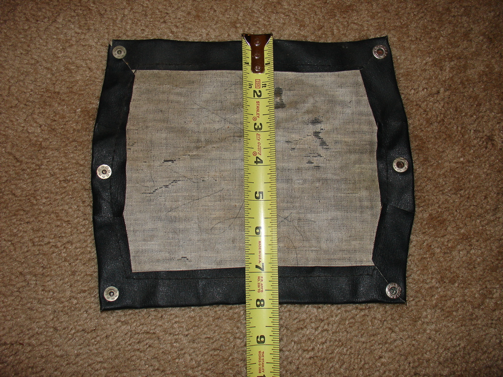

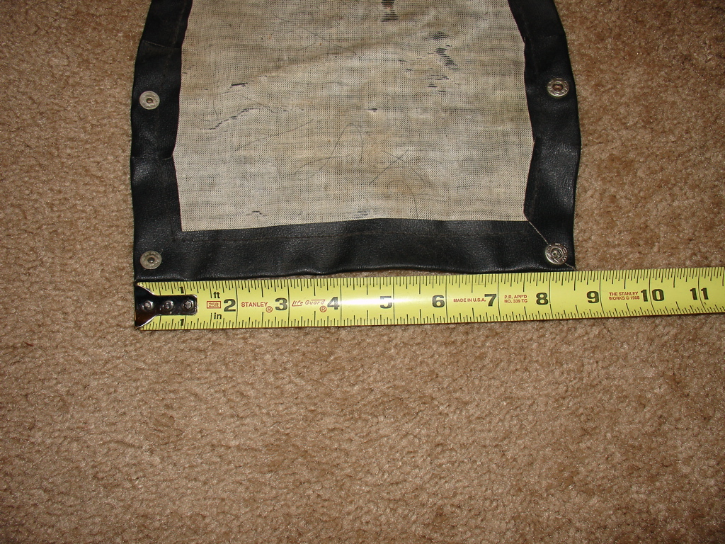

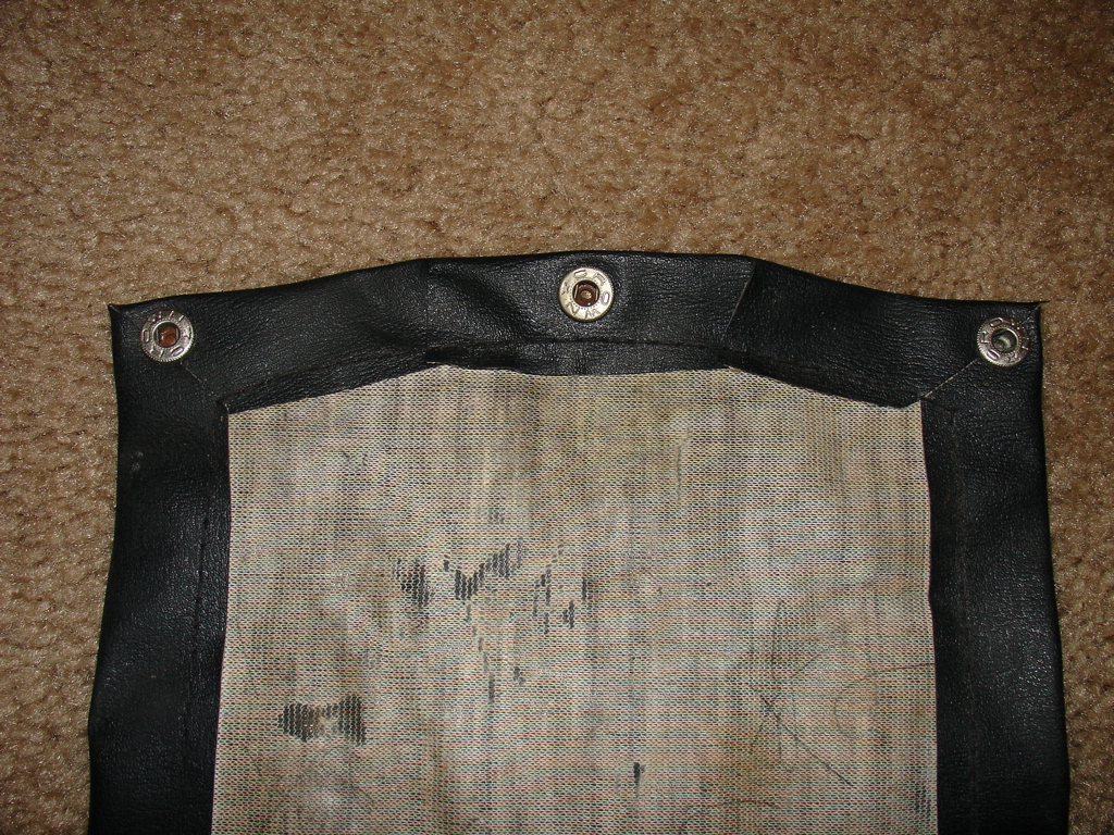

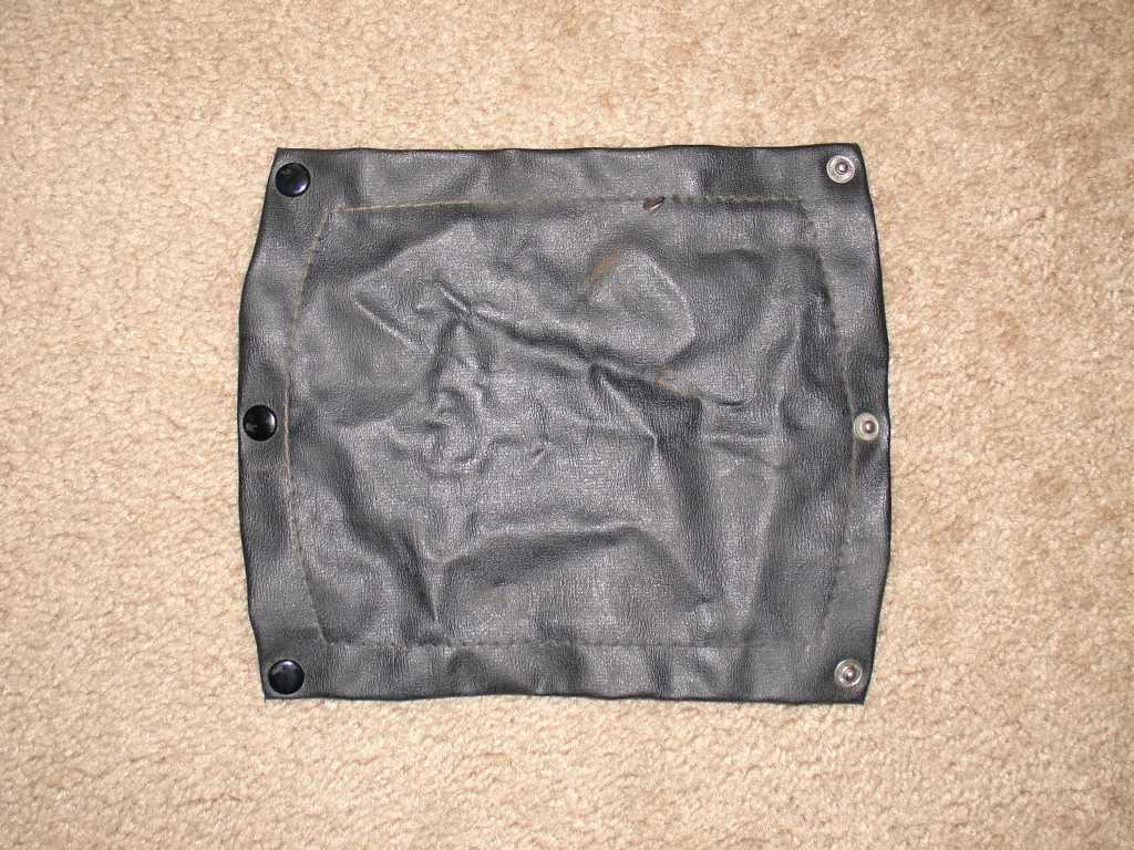

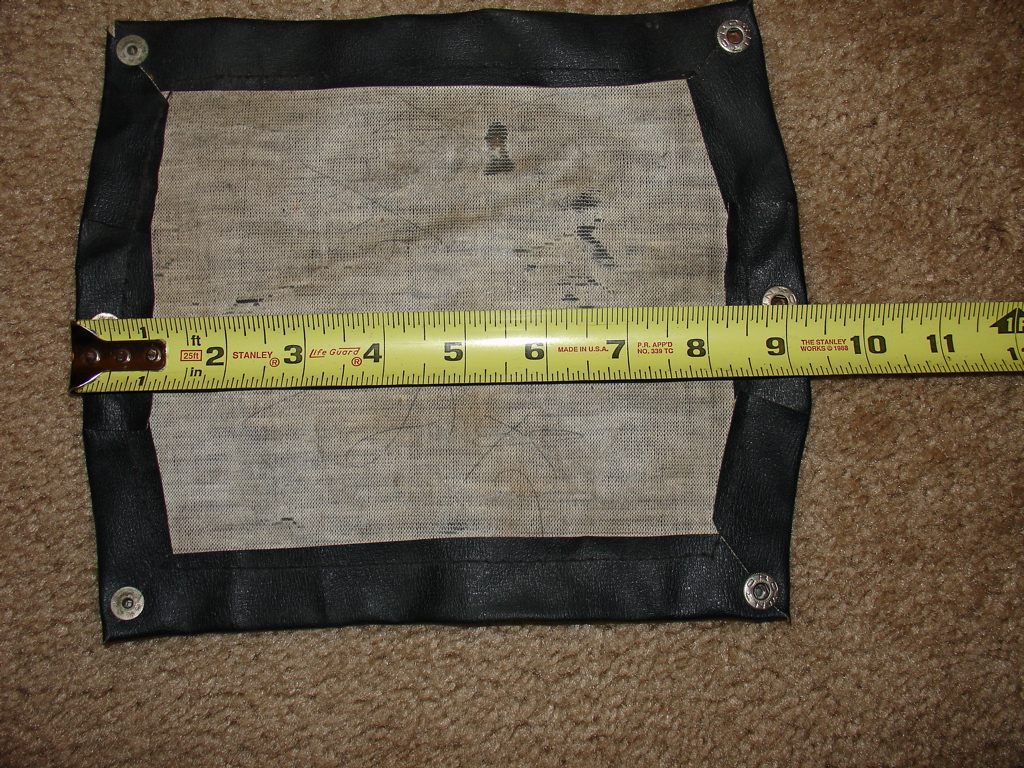

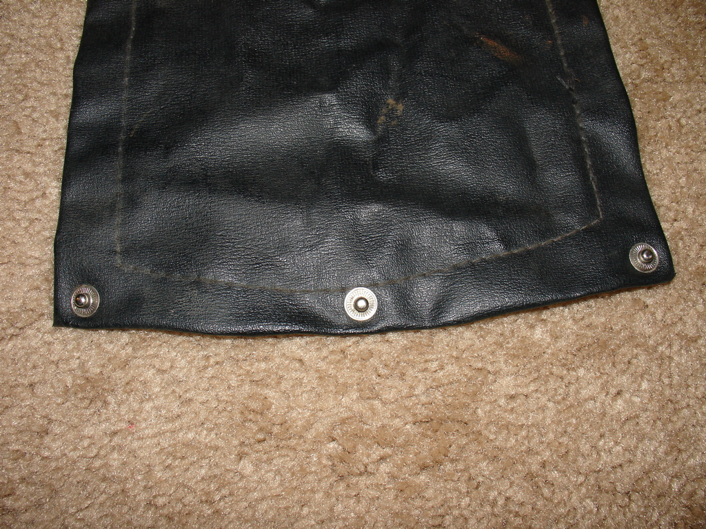

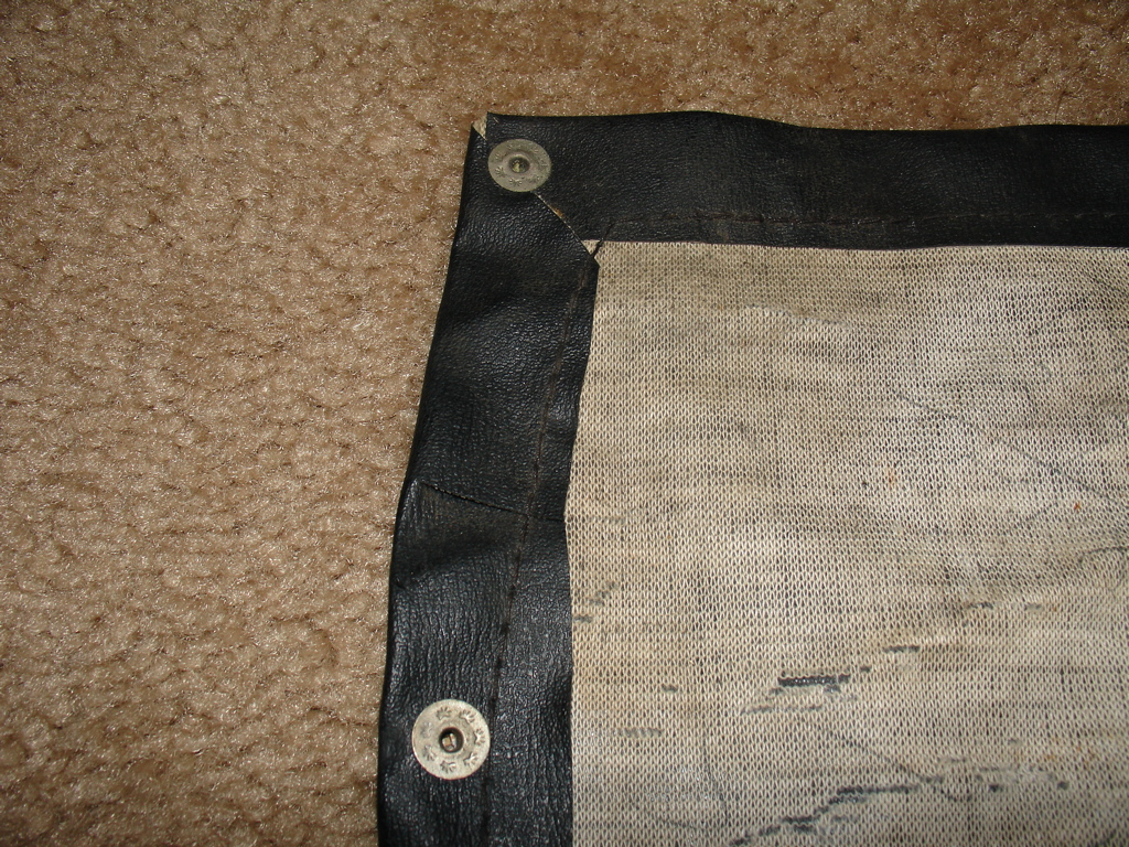

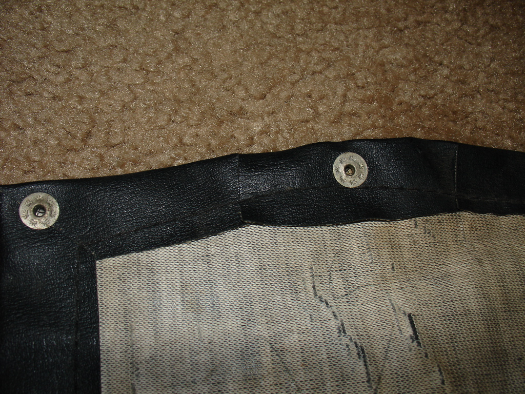

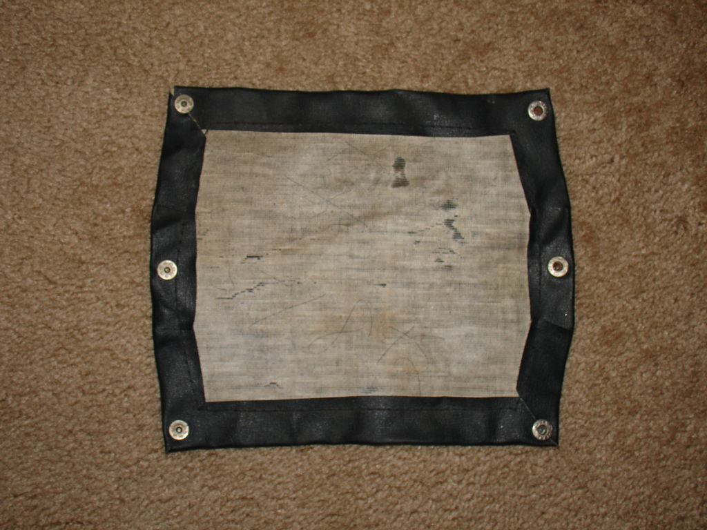

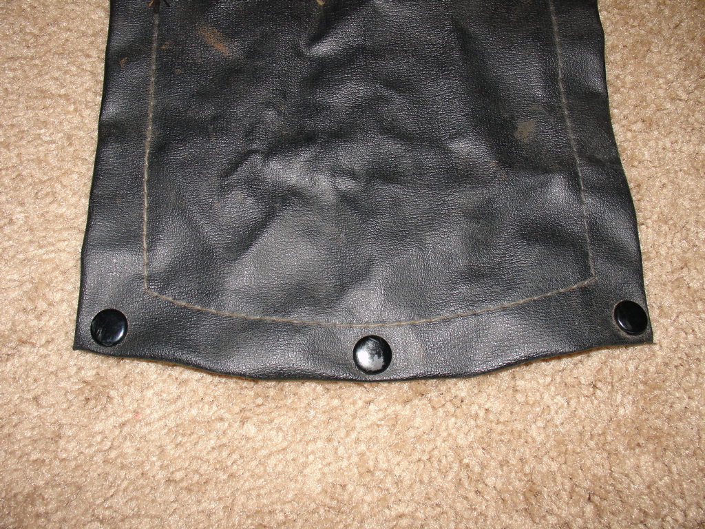

It's not square, it's a bit rounded on two sides. I've got one I found buried in my yellow car, which had the long pigtail fuse box. My red 240Z is a Series 2 with the short pigtail box, so it doesn't have one.
The grain of the vinyl appears to be a much finer grain than that of the early shift boot, but about the same weight of material.
The workmanship on mine is - frankly - pretty poor. I think the apprentices must have been assigned this job. Not all that well finished, nor accurately cut. Note that the two darts on the rounded edges are not stitched down. It looks like a really quickie job to me - cut it out, fold the edges, and sew it. And do it FAST!
Frankly, considering how sloppy the workmanship is on mine, I can't imagine that any two of them were exactly alike. The pictures and measurements below should be more than enough data to reproduce these.
