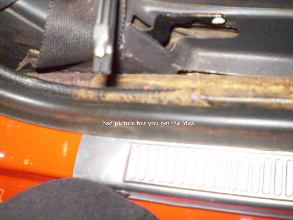

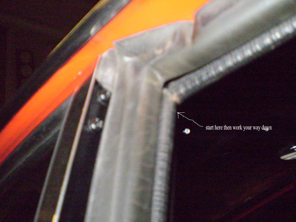

Zs-ondabrain Posted March 14, 2007 Share #5 Posted March 14, 2007 The welting is what holds the weatherstripping onto the body. Nissan was smart enough to not just trust the glue. Start in the upper corner, near the quarter window. Place the rubber into the corner and grab the smaller of the 2 weltings. push the welting into the corner over the thin layer of rubber that is over lapping the thin metal seam. Then work your way down the quarter window, and on down to the sill plate. The weather stripping should end half way across the bottom. Then move onto the upper corner again and use the longer welting to do that one. I use a rubber mallet for this particular weatherstripping application. Trust me, your hands will thank you later. USE CAUTION AROUND THE DASH AREA!! There is NOT a lot of room there so you may want to slowly use the handle of the mallet to press the welting in there or use your fingers. Sorry about the pictures but they might help. I just got done putting in my door weatherstripping as well. Good luck Dave Link to comment https://www.classiczcars.com/topic/23574-weather-stripping-woesquick-question/#findComment-202226 Share on other sites More sharing options...
