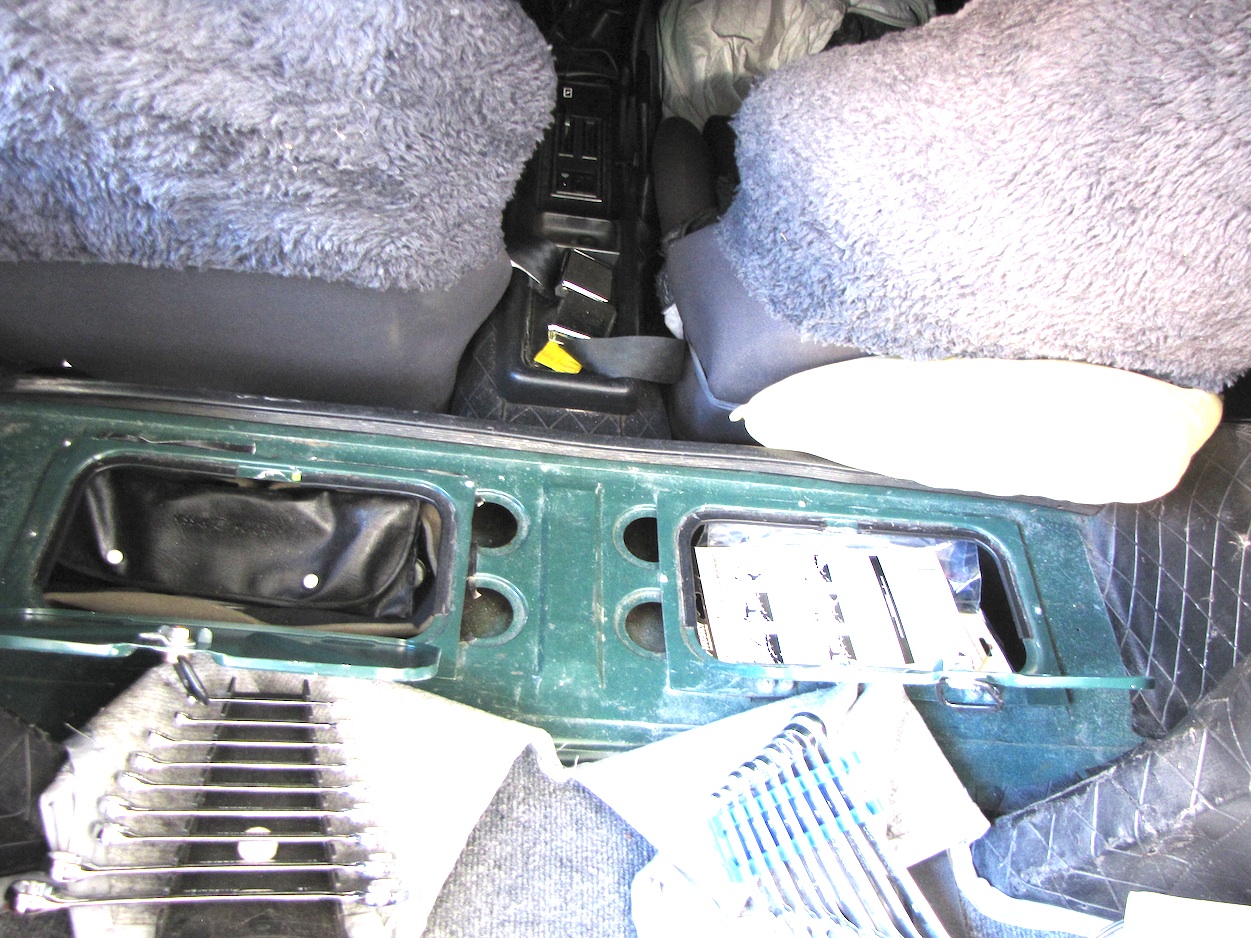

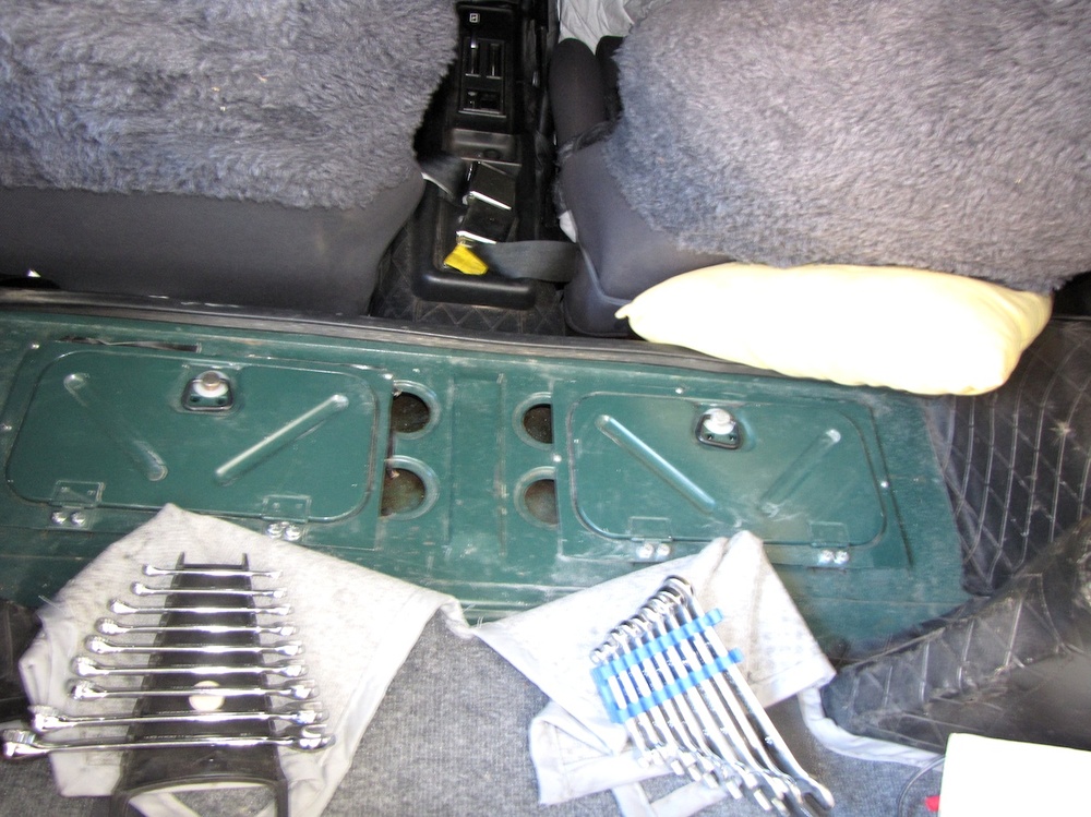

Black Dragon has replacement vinyl covers available see pg 43 of their current catalog. I bring this up because in the Series I, this storage area is unused. It makes a great speaker location when packed with fiberglass. The cover over the void is just linoleum and easily cut away.
My vinyl covers are plenty big enough for the jack, tool pouch, and a small tool kit with sockets.
