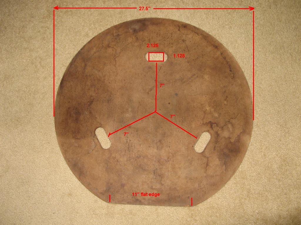

My 1972 cover is just the board: no plastic clips or velcro or anything else. There are no holes or marks indicating that I'm missing anything.
My measurements are slightly different than those above. Start with a 1/4" board and make a 27.5" circle. Give it an 11" flat spot. Make 3 hand holds 120 degrees apart that are 7" from the center. Each hand hold is a rectangle 1 1/8" x 2 1/8" with a half circle cut out at each end. Hopefully the attached picture will make this description make sense ...
