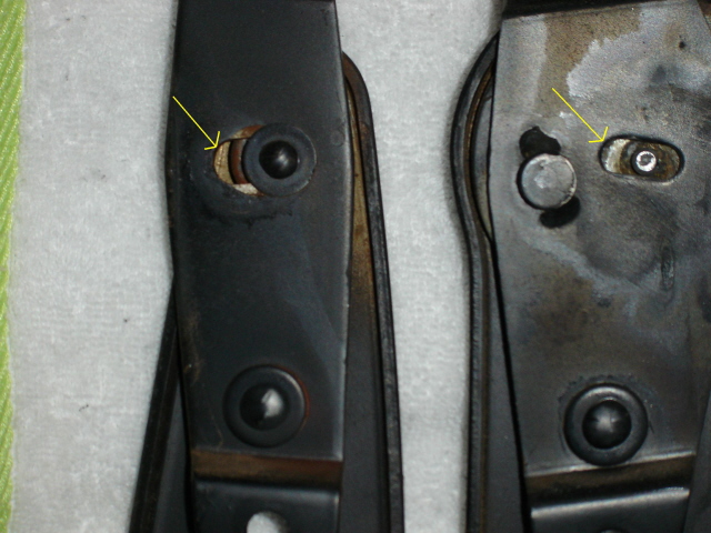

I'm 6'4" and concerned about fitting in the car comfortably after I replace the foam and webbing. I'll remove the spacers from the bottom of the seat frame but I'm also thinking about making a revision to the hinges.
The amount of recline is limited by the size of the oval in the hinge, (see picture), I'm thinking about opening up the oval about a .100". My concern is that the seat-back will hit on the luggage riser just behind the seat. I'm going to do the trial and error thing on the passenger seat to see if it works.

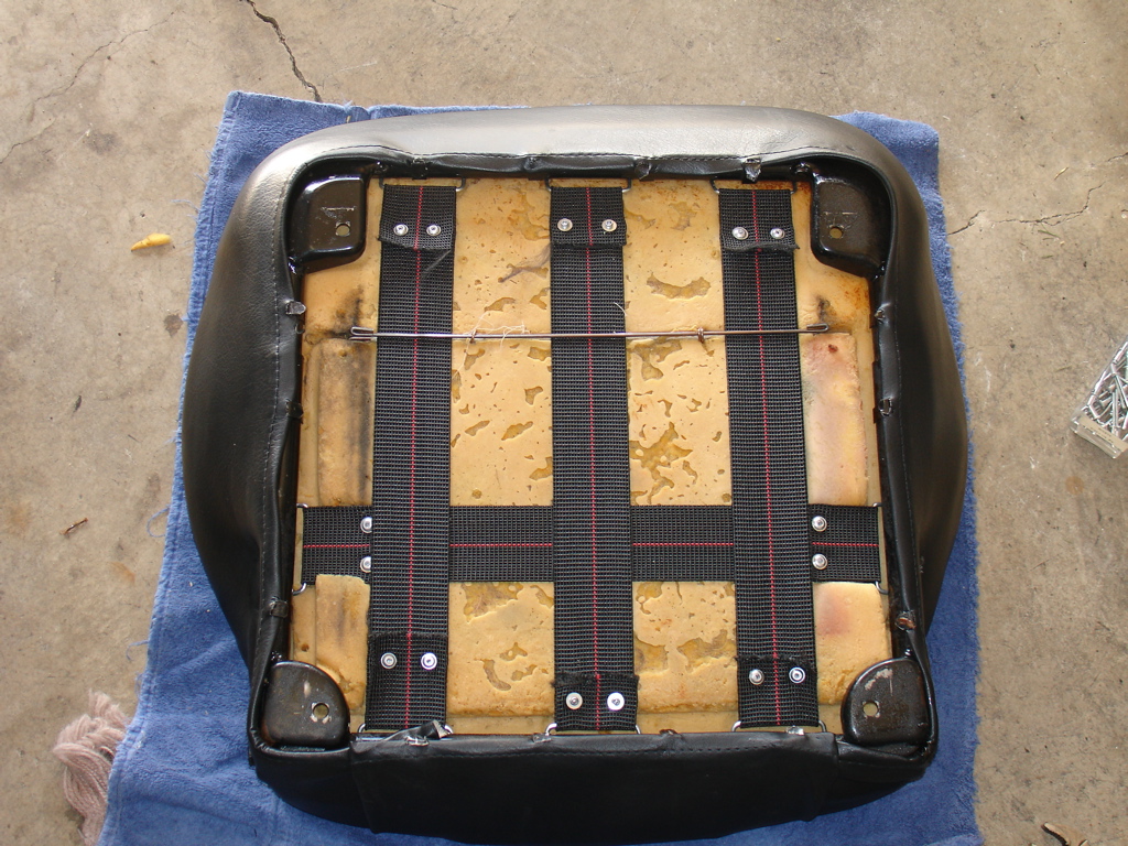

Arne - pictures are worth a thousand words!! I cannot tell, however how the piece of wire is attached? I have two pieces of that wire that "fell" out of my seat as I removed it and had no idea how they attached, or where they were supposed to go! Mine seemed to be joined in the middle with a small ring so they could form an " X " shape? Also, when I am attaching the webbing, should it be as taut as I can get it, or should there be a little "give/sag" to it?

The two wire stretchers per seat cushion are supposed to be attached to the seat cover through thread-loops on the underside of the cover through a slice in the seat foam. On my car, the webbing then ran between the two wires. The idea is for these wires to pull the cover down into the foam to contour the front-most pleat.
You want the webbing pretty tight. The exact dimensions will vary depending on the exact web material used. On mine, the one from side to side ended up at 13.25" - I tried 13.0" and I couldn't stretch it far enough to reconnect it. The three longer ones ended up at 13.75" long.
The difference was drastic. I will still end up replacing the foam and covers at some future point (plan to get it from CDM), but for now the improvement was great enough that my wife is now willing to drive the car. Before the seats sagged so low that even with all the spacers installed she couldn't see over the dash. (She's not all that short at 5' 6".)
