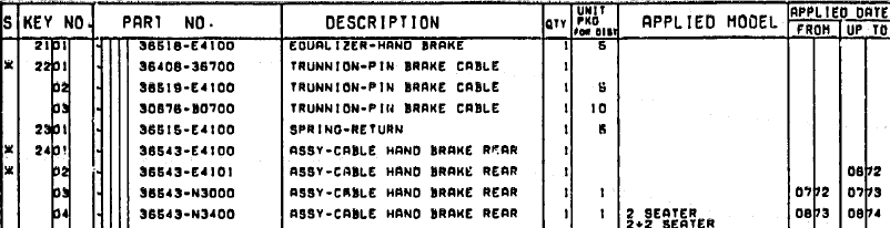

The parts CD shows 36543-N3400 for your car (see attached screenshot, bottom line). Courtesy doesn't list it, but NissanParts.cc does - http://www.nissanparts.cc/cart/?pn=36543-N3400

One question though, I have a late '74(delivery date dec. 1974 :classic: ). Shouldn't I be looking for part 36543-N4502 listed for 260Z's from 09/74 to 07/76?
At least that is what I found on the parts CD.
