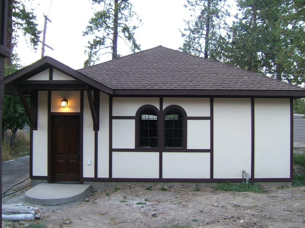

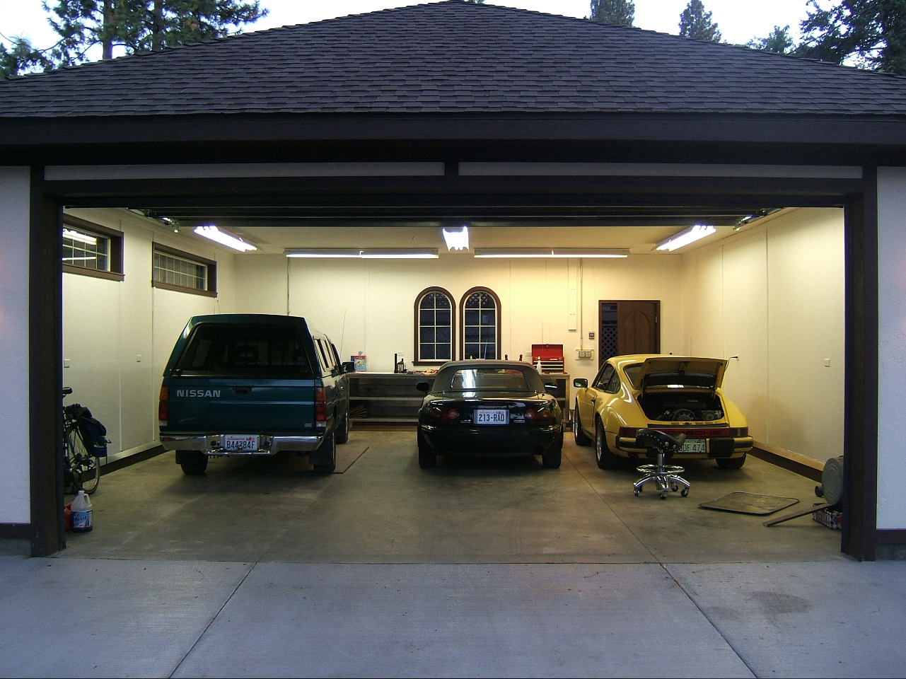

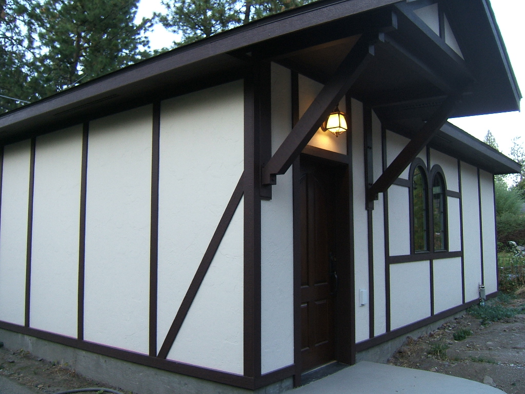

Hi Richard and all. I was pretty surprised to see this thread resurface. I began this thread (April '07) when I was in the planning stages for my garage. Things got rolling pretty good about mid-September of '07, and the building was pretty much roughed in by November of that year. Electrical was completed by about March '08. This spring and much of the summer was spent finishing the exterior and interior. Most recently, I powered up the hydronic floor heat about a week ago.
We ended up going with 26' x 30' dimensions. The door is an insulated 18' x 8'. Wall height was set at 10', with the ceiling height being about the same. Much like conedodger suggested, I poured a pit with buried conduit to fit a scissor lift. We also incorporated radiant floor heat in the concrete pad. I did use the SIP's panels alluded to earlier in the thread, and had R-48 blown into the attic. The building holds heat quite well.
Pictures as follows:
1. The house we tried to emulate the style of when designing the garage.
2. Garage mandoor, board and batten detail.
3. Arch top windows.
4. View from alley, garage door open. The pit for the scissor lift is currently covered by the reinforced plywood seen under the Nissan truck in this picture.

Generally, I'm really happy with this building. Right now the Z is tucked in there with a '91 Miata, a '78 911SC, and a '96 Nissan truck. It's a bit tight, but I'm not complaining...just happy to have stewarded this project from planning to construction and near completion. Thanks to all of you who made suggestions here and elsewhere - many great suggestions were incorporated into the end result.
