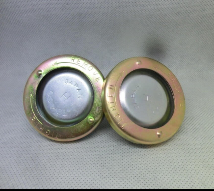

About the cylinder, yes my current cylinder is made by NABCO but I want TOKIKO lock type cap which looks period correct for my June 1972 car.

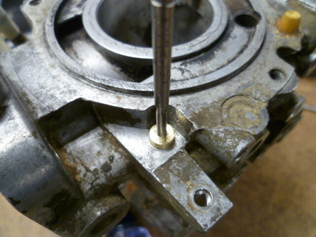

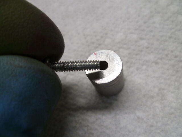

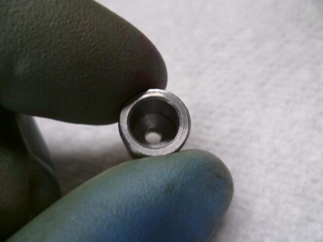

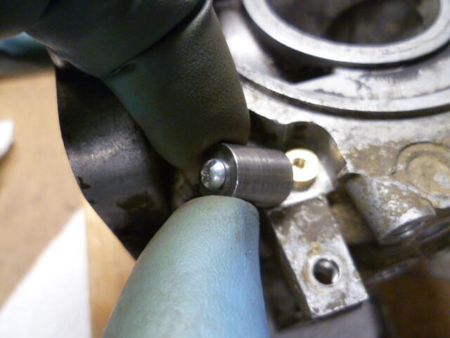

Kats, Here's some pics showing what I would try:
You're starting with something like this. This is a different carb, but the situation is the same:
Tap some threads inside the hole. You may have to drill it a little first to the appropriate pilot hole for the tap. This is an English 4-40 tap, which is close in size to M3 x 0.6:
Then I made a little puller adapter to concentrate the force in the perpendicular direction to pull the brass slug out of the carb body:
Put it over the brass slug and carefully run the screw in:
If everything goes according to plan, it should jack the brass remnant out like this:
If it doesn't come out easily, maybe try a little heat from a small torch:

Thank you Captain!! You show how we can go through the challenges. I remember you did some amazing work

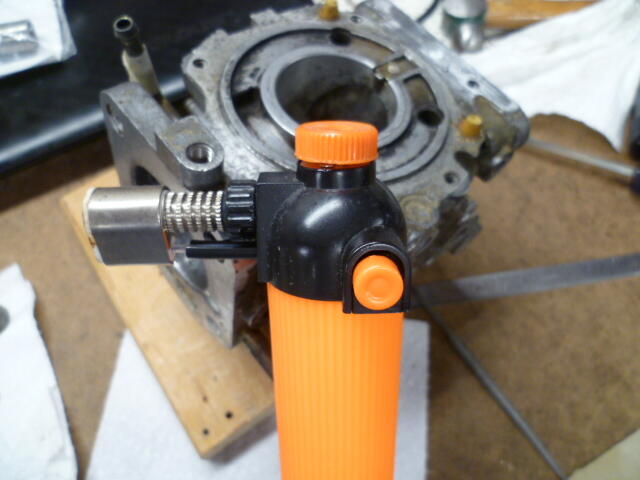

I have small inner pullers for this stuff , works great. just add some heat first before pulling
