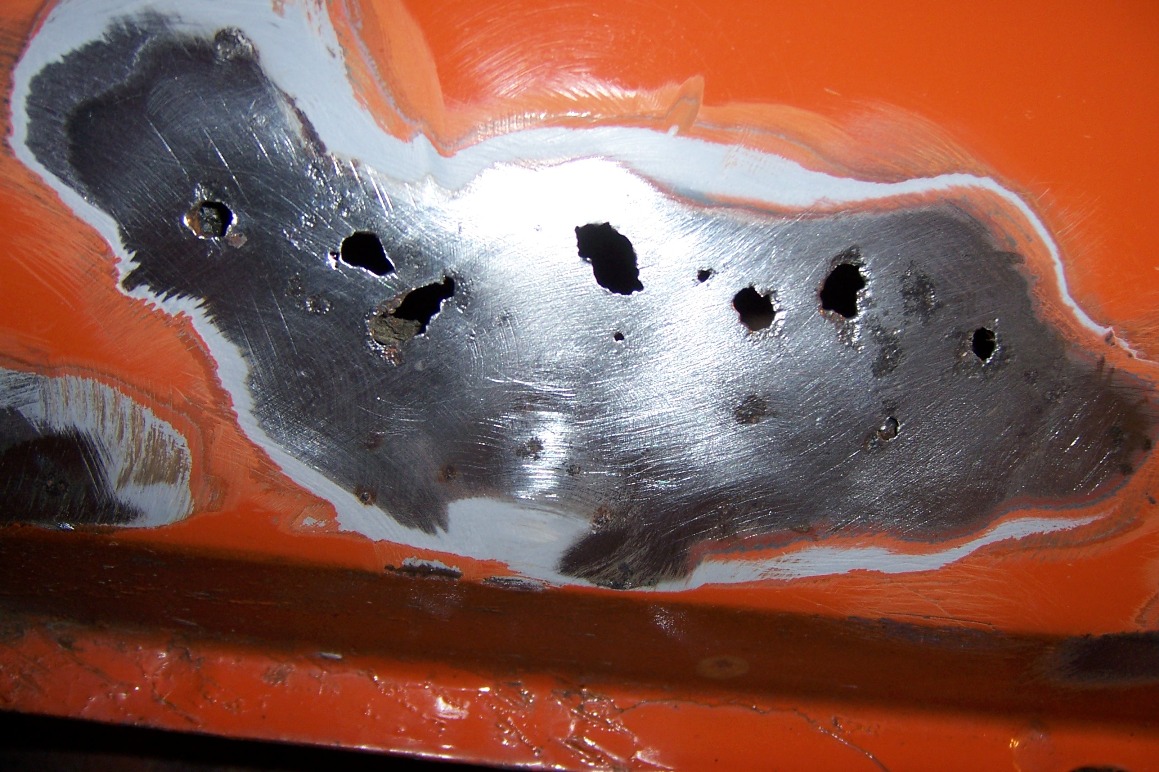

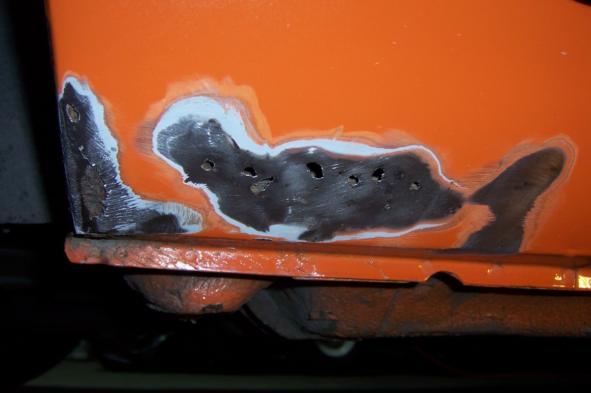

Here's what I'm dealing with... I got holes! This SUCKS! Anyone suggest a good plan of attack that is just short of cutting and welding?
Nate

If you really want a stop gap repair I would saturate the entire area in Metal Ready or Ospho or any of the Phosphoric acid rust eaters(even Naval Jelly-to keep close to the Coast Guard theme!)-especially the inside of the panel.
Then I would tap in the area(dent the holes in) and use fiberglass to seal the area, and get the body work as close as you can without using conventional filler(bondo/bog) then cove it with a high build primer and color coat it.
The Fiberglass will keep water from the metal, and be fairly easily removeable later on. By not using any bondo, you don't put anyhing in the area that will absorb and retain water to add to your issues. By using a Phosphoric acid to treat the rust from the indside, you will leave a Zinc Phosphate coating in an area that will be somewhat protected from contact, and the coating will help prevent new rust from forming in the area.
Hopefully that will give you the temporary fix you asked for without getting to involved or adding too much to the mess to ultimately be cut out and replaced!

Sorry Will, I have to disagree with you.
The Fiberglass is what I would also have recommended a few years back and would have been ok....for a while.
Since then, I've been introduced to POR-15 and the Power Mesh fabric that they use.
Nate:
In a fast nutshell, that rust you have didn't start on the OUT-side of the car, it started from the IN-side. The inside I'm referring to is the interior side of the rocker panel.
The proper repair is to cut out that bad metal and replace it with new metal.
You can confirm the lack of or the integrity of the rocker panel by looking at the backside of the panel through the circular openings in the INTERIOR rocker panel. The holes are for strength of the metal, but they allow you to see through to the inner side of the rocker. Using a strong flashlight, look in there and evaluate what you see.
If there is a ton of rust...replacement is the best and possibly ONLY repair for this.
If there is NO rust, and only in the rust-through spots do you see any rust on the interior of the panel, then you might be able to do what I'm going to suggest. How much rust you do accept is up to you.
Prep the inner part of the rocker panel as directions for POR specify. Use a nozzle to get the marine clean well inside the rocker. Then the Metal Prep. I know some may shudder at the thought of using a hose and water in the inner part of the rocker panel, but there ARE drain holes specifically for this purpose.
Then when you're ready to apply the POR, first use some tape on the OUTside of the holes. Duct or masking ... it doesn't matter, you're building a "dam" for the POR you'll paint from the inside.
Then paint the POR using a syphon nozzle and you'll protect whatever is left of the metal and at the same time "replace" the outer sheet metal...at least the part that's missing. Then you should be able to finish the rest of the bodywork.
I concur. 100% in fact. On the other hand I am not yet prepared to do a full resto on the car. I'm looking for the best temporary fix until I am at that point, which it sounds like the Power Mesh may be the answer.
So if I understand you correctly, I should be able to access a panel with "holes" in it by ripping out the interior?

E, Nate, if you use POR at this stage in a bandaid, you will have a hell of a time getting it out to do it right later on!
I have tried removing POR to prep for welding in that very area, I suggested fiberglass because it is a temporary fix(just like a bandaid) If you get POR in the area, you will have one of two things happen when you revisit it.
1) serious proiblems with removal-the POR will fuse the overlaping pieces of metal together meaning several layers will have to be cut out because it is no longer as simple as drilling out the spotwelds a layer at a time.
2) Welding on a surface to which POR has been applied will burn the POR off meaning you now have very tight pockets of untreated metal in the repair-a large part of what caused the rust problem in the first place!
My suggestion was to stop the growth of rust without complicating the future proper repair with the current effort. The inner rust treatment would have the same issues, but treat a piece of folded steel with Ospho and weld on the back side then open the fold treat a piece of folded steel with ospho then POR and weld the back side and see what I mean. Your advice could give a great permanent repair-under the conditions you stated, but that is NOT what Nate asked for, he wanted a cosmetic repair with rust stabilization that would not interfere with a later serious metal replacement-unless I read wrong. My RX gave him what he asked for a repair that would hold, stop rust and be much more removeable than anything involving POR!
Will
http://www.nortonautomotive.com/media/documents/S0000000000000001044/SpeedGrip%20Auto%20Line%20of%20Adhesives%207663.pdf
Nate, Theres metal adhesives available to bond metals vs welding.You could use this to put the metal back in your panel surface repair.
