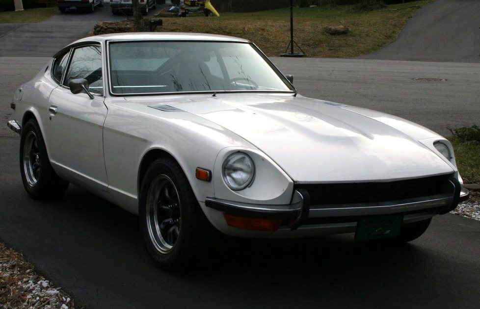

I mounted an angled and rotatable circular convex mirror to the left side mirror (now mounted on the passenger side) due to the fact the only way the left side mirror would work right would be to mount it up too far towards the front of the door to look right.
I look at the convex mirror to determine what's out there. So far it's working and I think the car looks just right with both of them. I hope to be at the Tail and the convention this year so come by and see for yourself.
