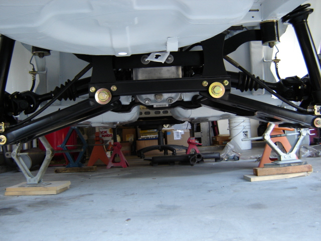

When replating nuts and bolts it's important to remember the quality of the finish is dependent on the quality of the parts you start with. If the bolt heads are all pitted, the plating will look a little dull becasue the light reflects differently. Zinc and Cad plating isn't like chrome where you use a copper layer to fill in any imperfections. You platte over the bare metal and you will see the imperfections. If you rounded the corners of the bolt head when you removed it, then you will still have rounded corners when it's done. I ahve plated many parts for Datsun people and all have been very happy with the results. If anyone doubts my ability to do quality work, then use someone else. I do this as a favor to the Datsun community because I know it's hard to find someone to do this work. I use a professional plater that I have a special arrangement with to give me a pricing structure that the individual restorer can live with and I can make a little money off of as well for my time. I tried to do it at home for a while but to get consistent results, you need a much larger set up than the home user can justify.
Paul,
Ty to find an outfit that has a barrel plater, this is how I got mine done. A barrel plater is just that, a barrell. The parts get put into the barrell, the barrell rotates in the various baths and the parts get plated.
If the supplier has a large enough barrell, you can also get a variety of brackets, linkages, springs, etc. done at the same time/one price because with barrell plating it's typically one lot charge. The only pain was cataloging all of the nuts, bolts, washers so I'd know where they went on the car once I got them back. My one-time cost for plating was $88
Because of environmental regulations, CAD plating is being replaced with zinc plating for most industries, (ASTM B-633). It's getting harder to get a new permit for CAD plating not that it's easy to get one for zinc. There are a number of engineering drawings that still call for CAD, these are mostly military or government drawings. My point is that you'll have an easier time, (and probably less expensive) finding a supplier that does zinc plating. Zinc plated hardware will give you sufficient corrosian protection.
Ace hardware has a variety of metric fasteners but they use clear zinc, not the yellow. As pointed out, I also recommend you clean your hardware thoroughly prior to sending it off for plating.
Bruce
I use Royal Silver and Virginia Plating (located in Norfolk and Newport News) in Virginia. You can find them using www.anywho.com. I had my hardware yellow zinc plated at Virginia and chrome done at Royal). Cadium is very expensive anymore due to EPA regs and arsenic used in the process. The results is very impressive. Since my Z never sees rain I expect the finish to last a long long time. You should ba able to locate a plating shop in your area or down in the Charlotte area.
