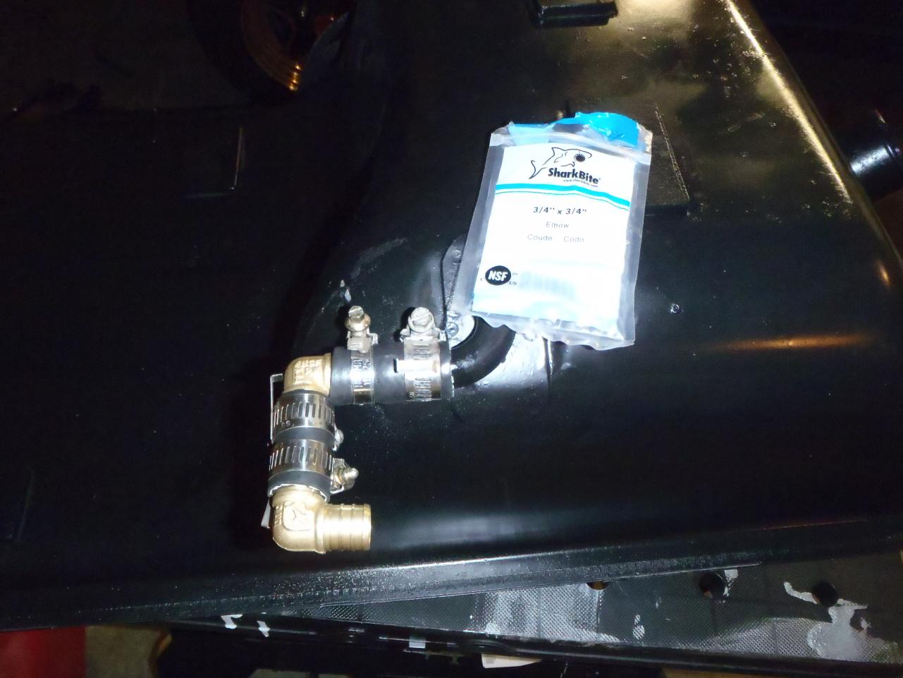

I just did my tank, using a combination of advice. I bought no factory hoses, and took a different approach to the 180 degree bend necessary for the large hose on the right rear of the tank. I used two 3/4 inch 90 degree brass fittings. See picture. post-17507-14150814618786_thumb.jpg

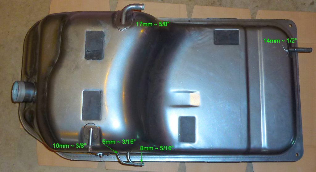

71 240z fuel tank with fitting sizes (not hose sizes)

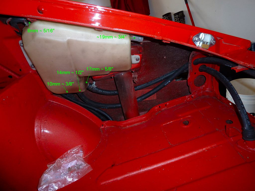

71 240z evap tank with fitting sizes (not hose sizes)

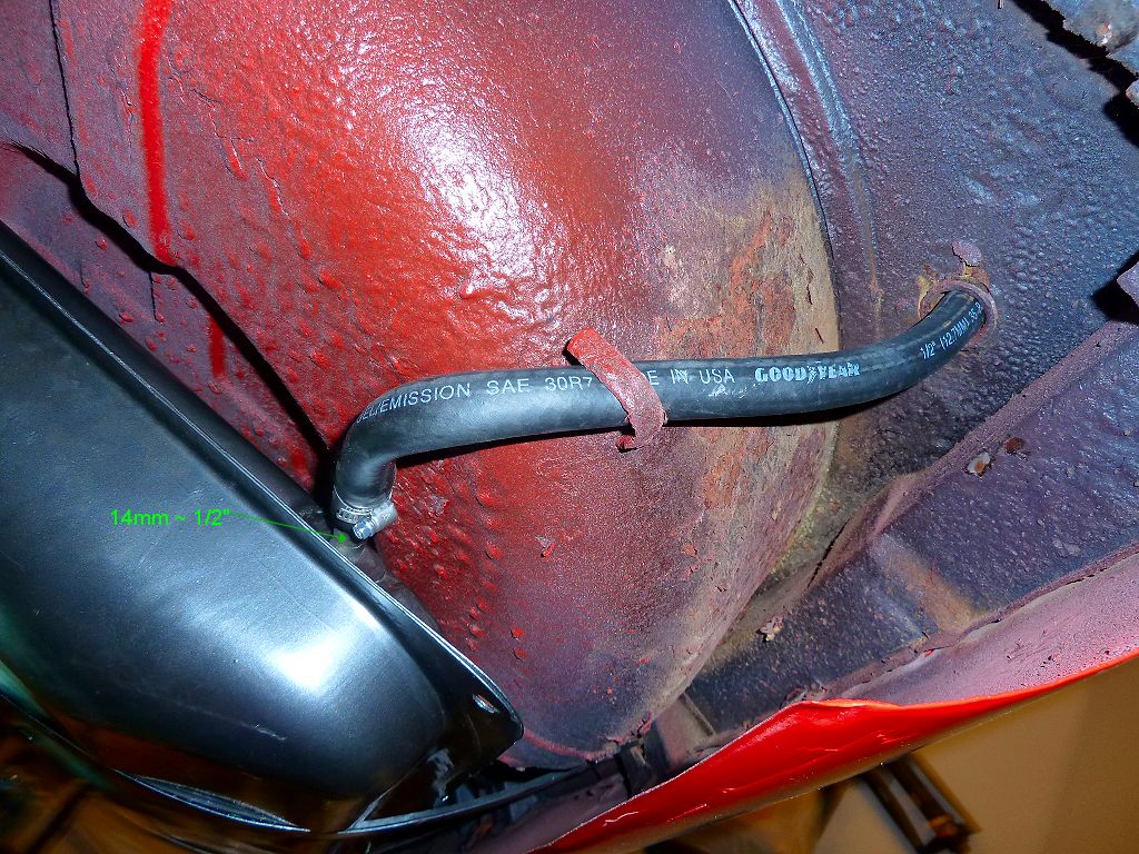

Rear left connection. I used 1/2" fuel hose and it worked very well. I obtained the hose from a truck supply shop. Finding fuel hose over 3/8" is difficult and as mentioned in a post above, only very low pressure (~400psi) hydraulic hose MAY work.

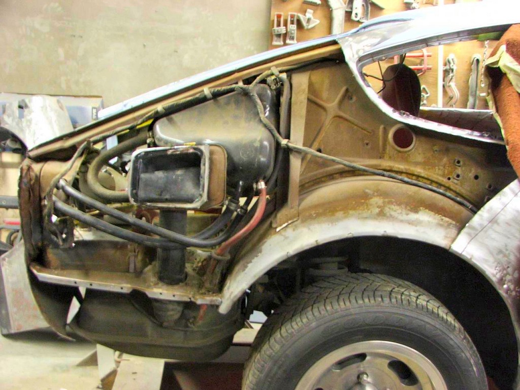

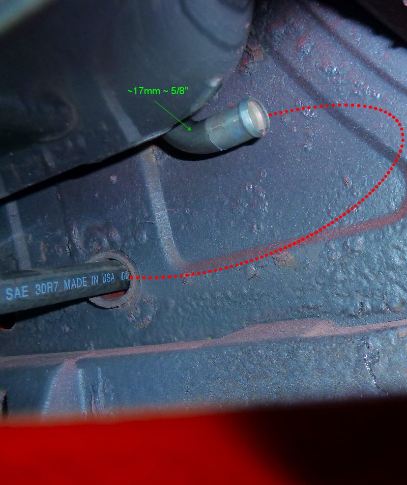

Here is a view looking up at the vent line at the rear right top of the tank. As you can see the vent line points away from where the hose comes through the floor. This calls for a 180degree turn in very close quarters as the top of the tank is pressed up against the rear hatch's floor.

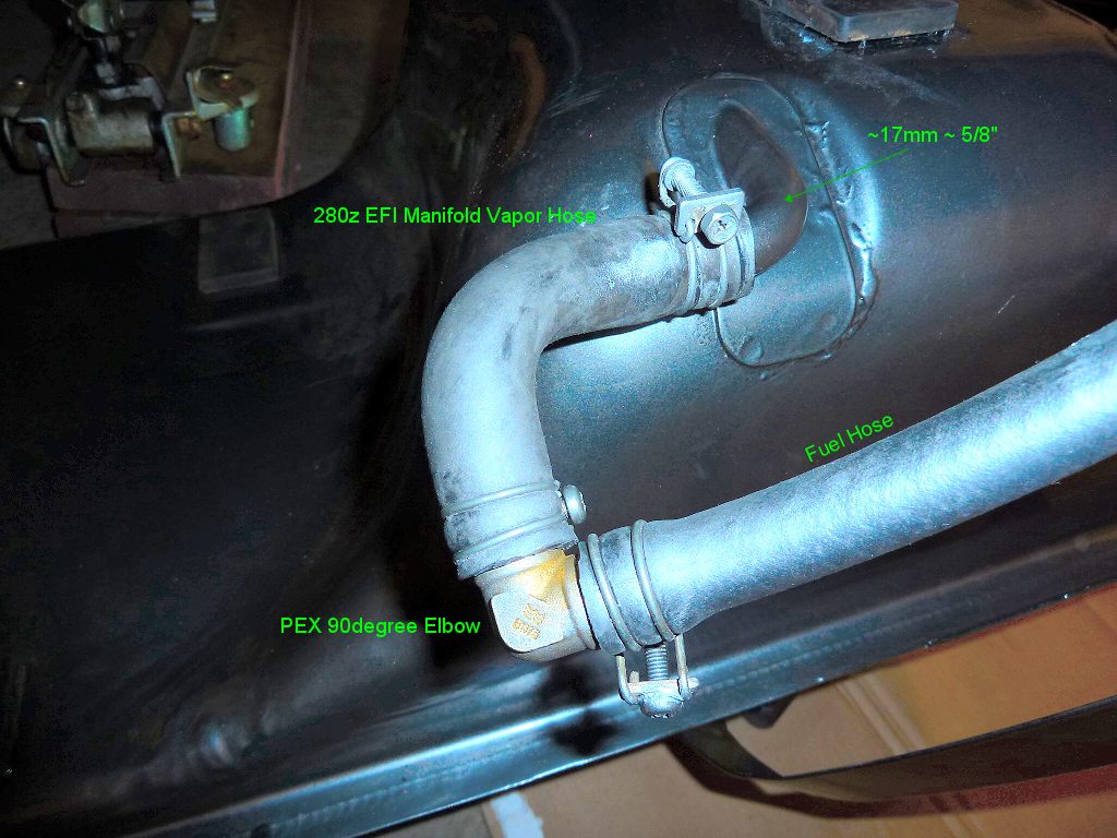

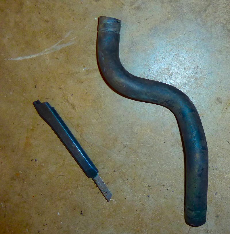

There are many ways to make the 180degree turn. Here is mine: I used fuel resistant hose from the manifold vent hoses from a 280z EFI system. This one had a 90 degree bend and it fit on the 17mm / 5/8" fitting so I did not need 5/8" hose (which was a good thing as I could not source it).
I used a PEX 90degree water hose brass fitting that I sourced from a hardware store to connect the EFI hose to a 1/2" fuel hose. Yes 1/2"! You can make it fit over the fittings on the gas tank and on the evap tank (heat from hairdryer or microwaves water helps as well as lithium grease). The EFI hose and the PEX gave me 180 degrees.

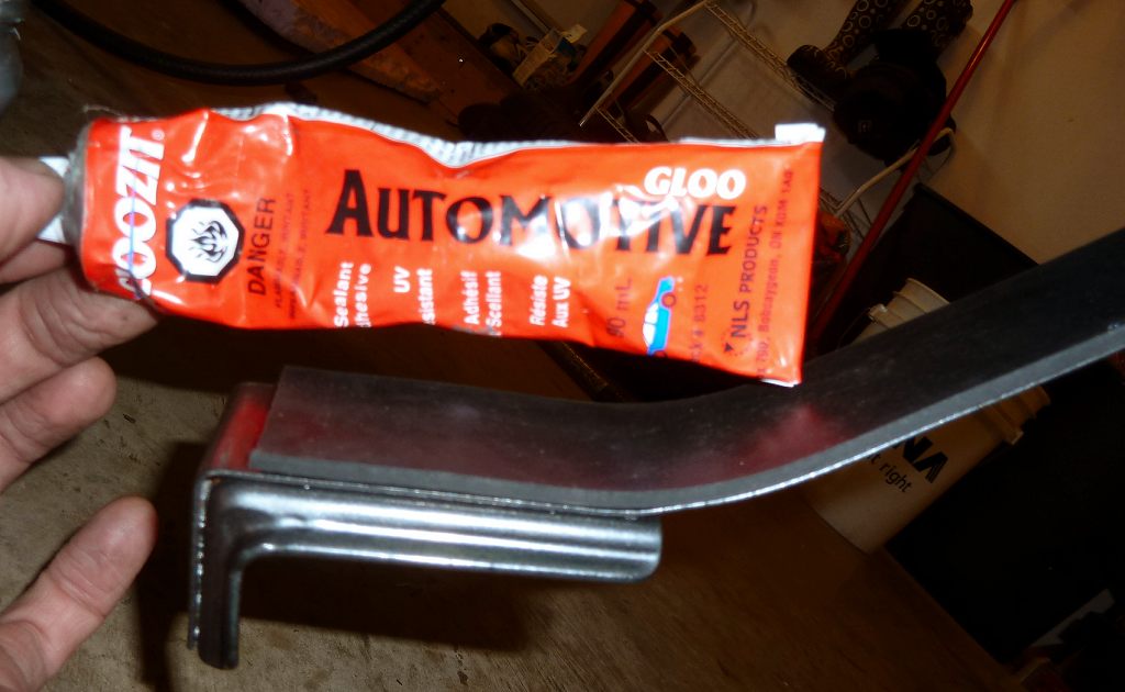

For the tank straps, I used rubber that I sourced from a hardware store and automotive goop to secure it to the strap. This stuff was ~ 1/8" thick.
