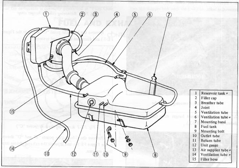

i just ordered hoses and I'm in the process. Tank is down and out. Trying to figure out sequence of removing these very stiff hoses OUT.
REASON IM WRITING found a source of metric hoses that are all modern fuel(ethanol ) rated
Belmetric.com. A source of metric fasteners and hoses
the braided 17 & 14 mm ...search RH17 and RH14 for CONTINENTAL vacuum, fuel , etc hose
the 5, 8, 10 mm ...search RMH 5, 8, 10 FLENNOR Multi fuel hose
19 mm is not available
now to the bends...They offer stainless hose benders. A wire wrap that supports the hose and makes the turn
RHBEND 23.6 for for the 17 mm hose
RHBEND 21.2 for the 14mm
RHBEND 16.5 for the 8mm
NOT cheap but the correct products. Sold by the meter I got TWO meters of the 14, 17, 8, and TWO ea 14-17 benders!!!
TOTAL $199.64 free shipping. I think I could have gotten by with one meter but?? It's just money. The labor is what is kicking my but at 71.

FWIW: the top hose from the eVape tank to the fuel pipe is 22mm not 19mm as shown. I used a 7/8" fuel line w/no issues.
Q: Has anybody put a metal eVape tank into a series 1??? I got a hold of a metal tank and couldn't make it fit.
