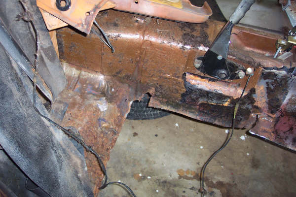

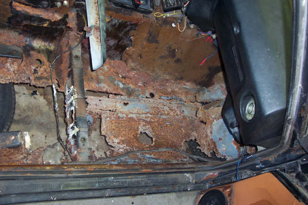

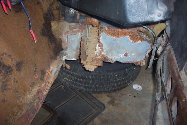

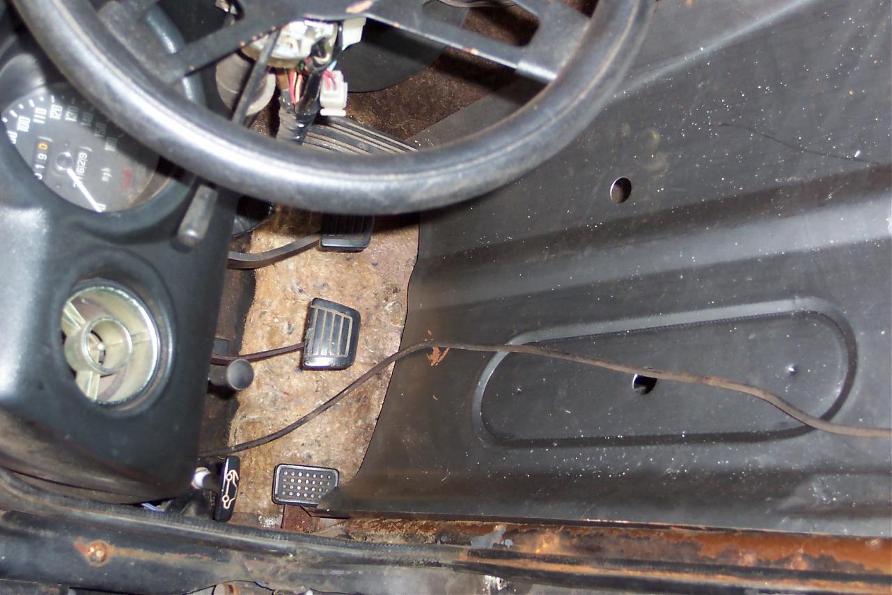

I am continuing my floor pan replacement project. I have cut out the old floor pans. As you can see, the rust was really quite bad. After cutting out the old floor pans I started trying to figure out how to get the pans to fit. I think I am in for quite a job. Looking forward, the front section is also quite bad. I bought some sheet steel from a local supply company to cut out the patch panels for the other portions. Any thoughts comments or guidance is welcome.

The good news: You didn't have to cut out much metal....it had mostly rusted away.
The bad news: The support brace that goes in front of the firewall and just visible in your 2nd photo of the first post...that's missing a section of the metal that goes under the floor pan. Additionally, that much rust in the floor pan would indicate that you need to check out the rocker panels as they may be close to gone also.
The extra sheet metal you bought may come in very handy for the firewall, but the formed pieces available from Charlie Osborne may be far superior to anything else. See if you can get that lower support from him in order to re-strengthen that floor pan.

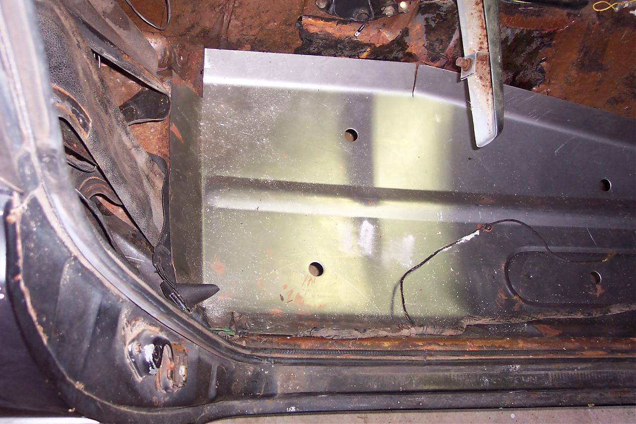

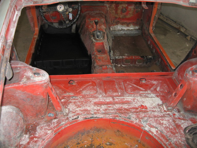

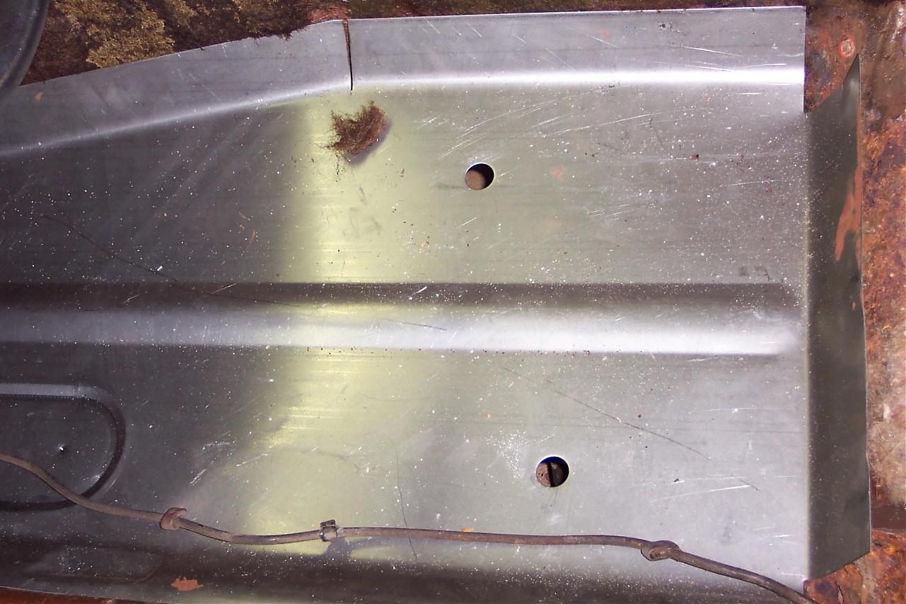

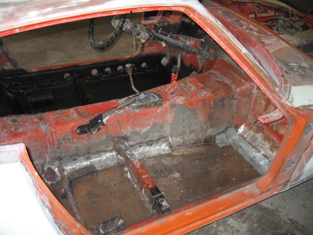

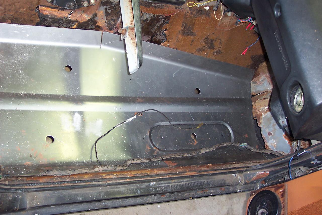

I went through this project last year. I cut out the old panels and had a shop weld in the new replacement pans from Charlie Osborne. The PO had used fiberglass replacement rocker panels so these got replaced too.The series of attached pictures (in 2 posts) may help show where additional metal was used to tie in the floorpans.
The final pictures should help keep you going. Good luck!
