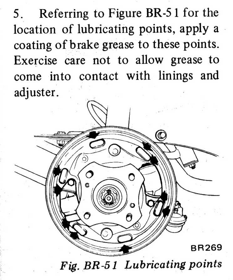

Also, there are twelve points in each assembly that MUST be greased with a high temperature grease.

Twelve grease points per drum setup, see the attached excerpt from the 240K GT export manual. Oh yes, in this version there are only ten grease points!!
