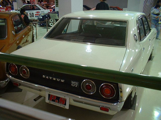

I had allway thought that a GT was a 2 doors, but looking through this site http://blog.goo.ne.jp/midget_tmk/m/200604, I came across a "Datsun 240K GT" 4 door. Is this something that has been made up, or JDM ?
