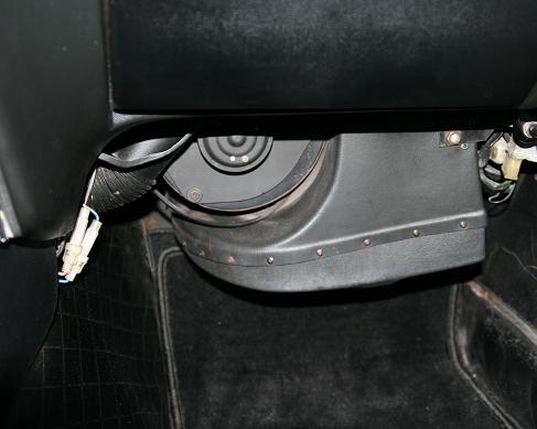

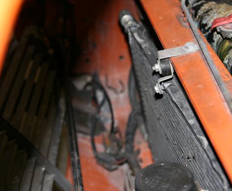

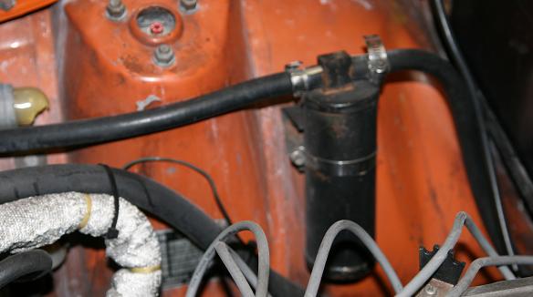

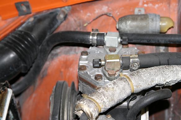

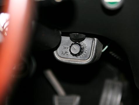

Here are a few pictures of the unit...(I think) I'm sure it's an aftermarket system so is there any value to leaving it in or out.

Remember if you do have the a/c recharged, you will need to buy a new reciever/dryer as that is a crucial part to replace every three years or so to prevent corrosion and moisture in the a/c system, not to mention the the desiccant pellets inside will break down and clog the expansion valve which can damage your compressor, not good. They usually run about $60.00.

MSA makes a kit to convert the old York compressor based systems to a more modern, more efficient Sanden rotary compressor. With that, it's really not a bad system. 76Datsun280z is refering to a factory system which yours is not. Obviously he got his advice from someone who repairs ac for a living. The drier on your car (mally02) is a generic drier and costs less than 25 bucks if you know where to get them. I wouldn't necessarily replace them every three years but I would replace it when installing a new compressor in a system that hasn't been working for a while. My advice would be, run a flush through the system, change to the compressor I mentioned, along with a new rec/drier and charge it with Freeze12 or one of the non hydrocarbon R12 replacements. R134a runs at too high a pressure for my liking. The modern systems that are factory built and installed to work with R134a are fine with their climate control, etc., but I wouldn't retrofit a R12 sytem to R134a nor would I be too interested in an aftermarket bolt on system that uses it. These are just my opinions but they are based on almost twenty years of expericence with ac both home and auto.
Looks like you have one of the original Dealer Installed systems.. note the old York piston type compressor. Those systems won't cool the car and by todays standards for A/C they are junk.
The R134a system that MSA offers - is just as bad. Yes - it has a better, smoother compressor that takes less hp to run - but the system still has to suck air through the evaporator - then blow it through the heater/fresh air vent system.
The only A/C system I've found that will actually cool a 240-Z, is the Vintage Air Super Cooler III. It replaces the old heater core, with a single unit that combines the A/C evaporator coils with a new heater coil. The system then blows cabin air through the heater/AC evaporator... and hooks up to the existing dash outlets and defroster outlets. The new Vintage Air system is designed to run on 134a... so it has smaller tubes and more of them in both the condenser (a multi-flow type) and the evaporator. If there is a problem with it - it is that the new Vintage Air system does NOT use the old heater/vent control levers...

I forgot about that system. I installed one in my brother-in-law's custom 58 Chevy wagon a couple years back. It's a 'designed for R134a' system. Cools that big car very well, vent temps below 30 deg. But back to the the factory installed system. Though it's not the most efficient design, I've done a couple of Z's for my friend's shop using the old dealer installed system, a better condenser, the Sanden compressor, and Honda blower motor and the results are more than satisfactory. Especially when compared to the York system as it was installed. The York system would only achieve 38-39 degree vent temps but with upgrades I've got the center vents down to as low as 27 degrees which is, like I said, more than sastisfactory.
