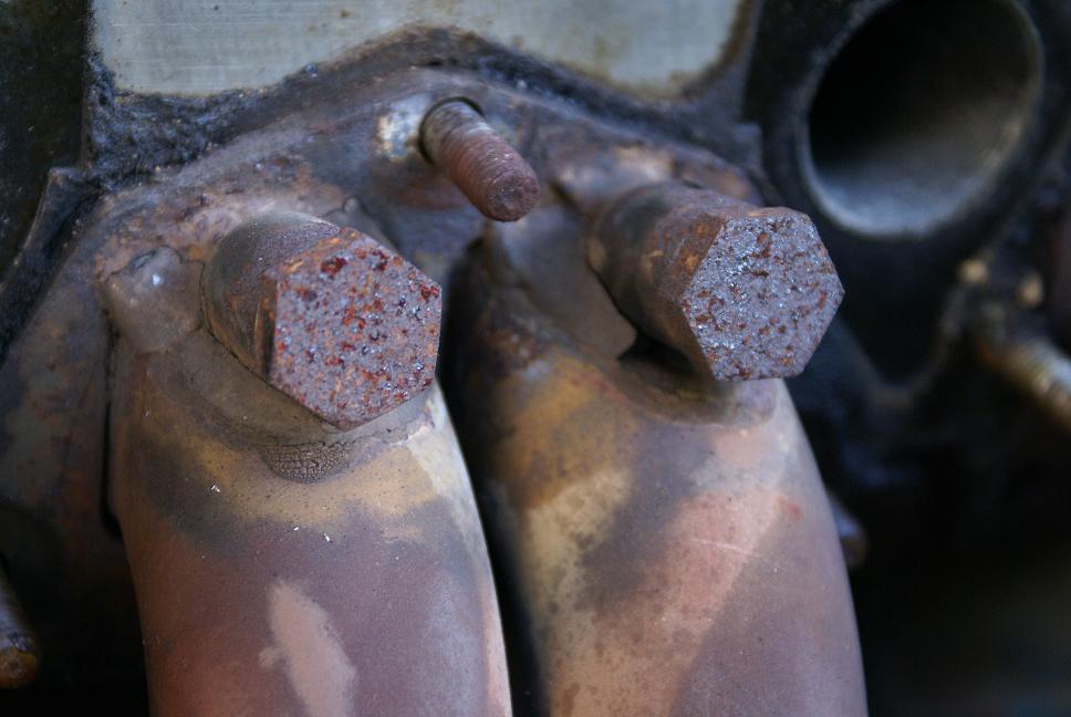

Since Last Week I Keep Hearing A Clicking Sound From The Engine Bay When I Step On The Gas. I Asked Someone Who Is A Mechanic And At First He Said It Could Be The Exhaust Header Or A Bad Spark Connection, But After A Search Through The Engine He Is 100% Sure It's The Header Because There Is A Crack On The Header Where The Bolt Is Located. I Have Never Heard A Clicking Sound Coming Out Of A Crack Header Before. Could It Be The Exhaust Header?

First off, is it an exhaust manifold or a tube header ? You said it's leaking around the bolt hole, which one ? You have the bolts that mount to the head and the bolts down at the collector that the exhaust pipe mounts to. A manifold is going to be cast iron, a header is going to be steel tubes.
first i thought the crack is on one of the exhaust header bolt but i guess i am wrong there are more than one crack now. please look at the picture. the cracks are on each tube of each header pipe. i dont know why there are small tubes on each header pipe.
the sound doesn't diminish after the engine is warming up, it actually gets worser after the engine warms up.
