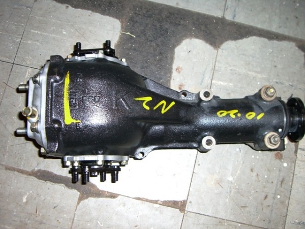

Hey all, I need some help identifying this differential. My stock r180 has gone out, and I'm looking for a suitable r180 replacement. I stumbled across a 73 240Z and a 79 280zx auto that had what looked like an r180 (which I believe the car came with) but I noticed that it had snap in stub axles, which threw me off. My stock r180 has bolt in half shaft stub axles instead. I didn't pull it, because I wanted to be sure that I got a r180 instead of an r200.
The pictures are of the 73 240Z's differential. I'm hoping I identified it right as an r180, because I found the 79 zx auto, which would come with the 3.54 gearset. I've got my fingers crossed! LOL

Note: this is the dirty differential from the 73. I'm hoping to use the one I found on the 79 zx.

The differential in the pictures is an R180 with the bolt-in stub axles. I sell a modified 240Z stub axle that snaps into R180 differentials that use the snap rings.

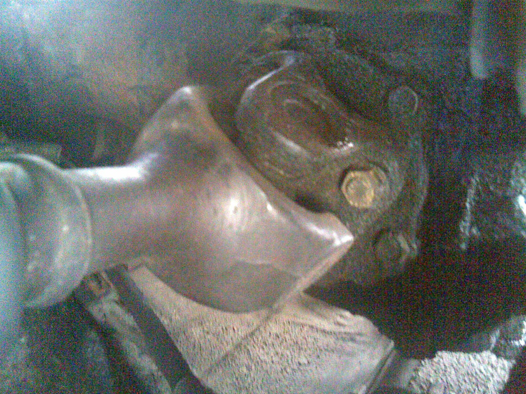

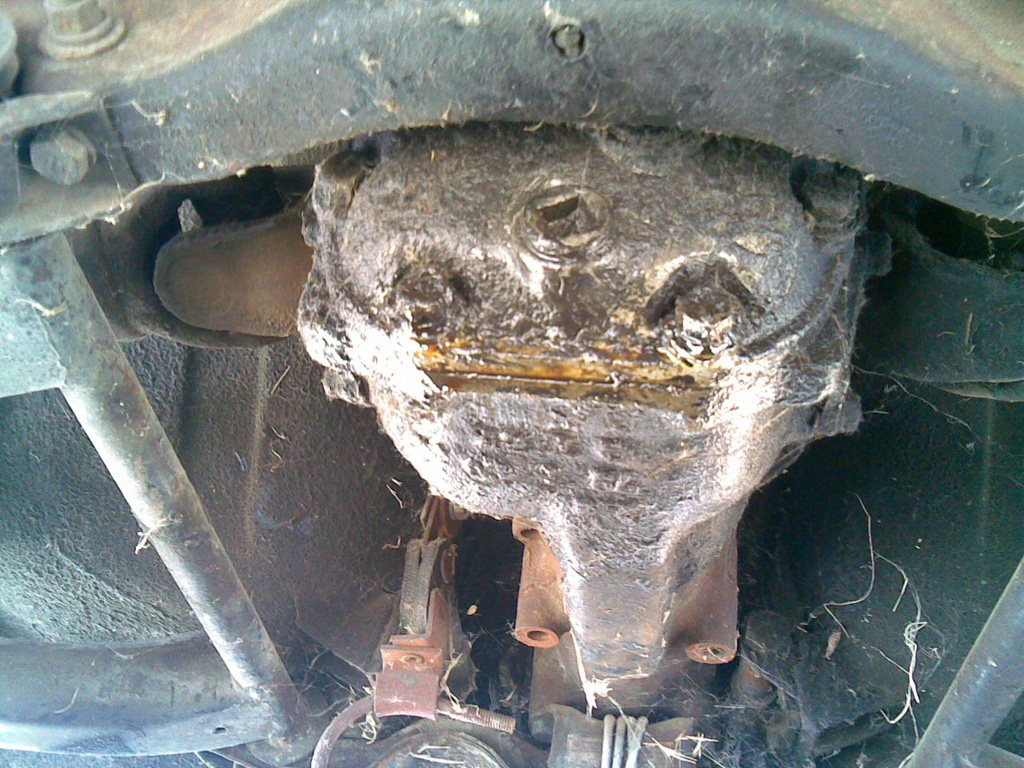

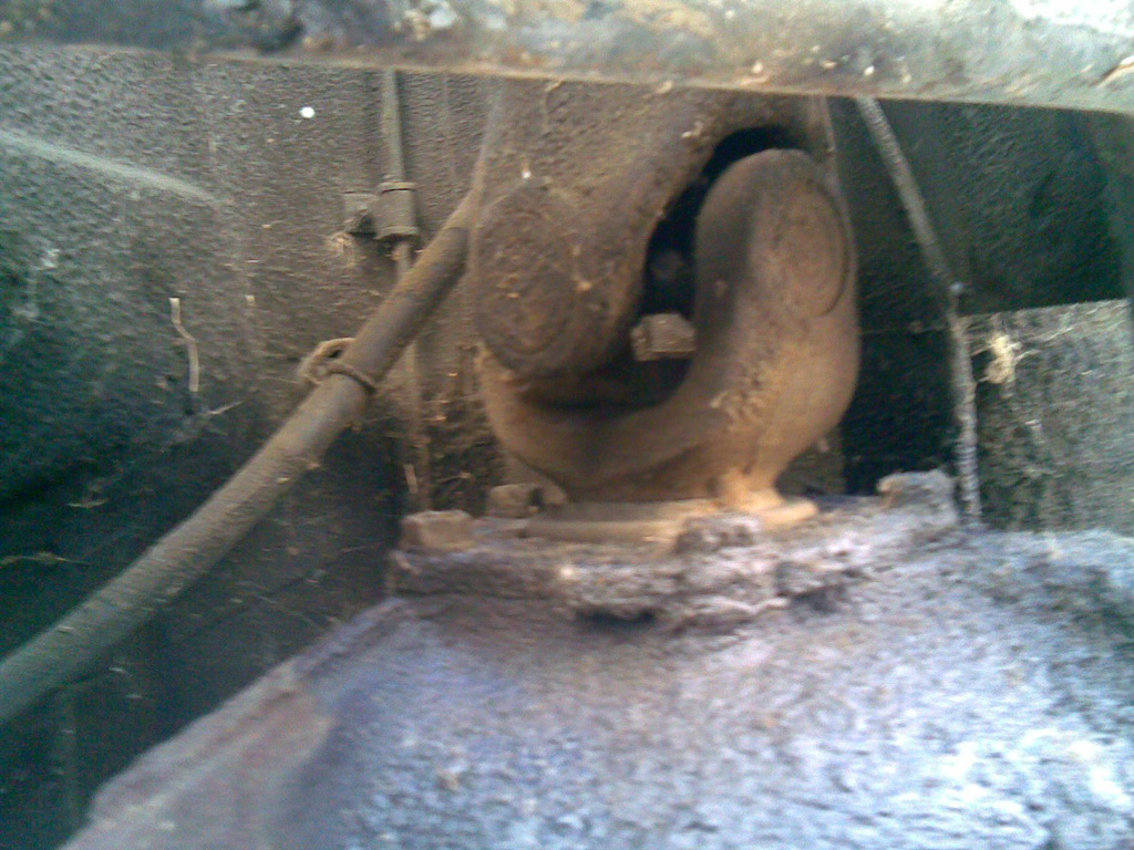

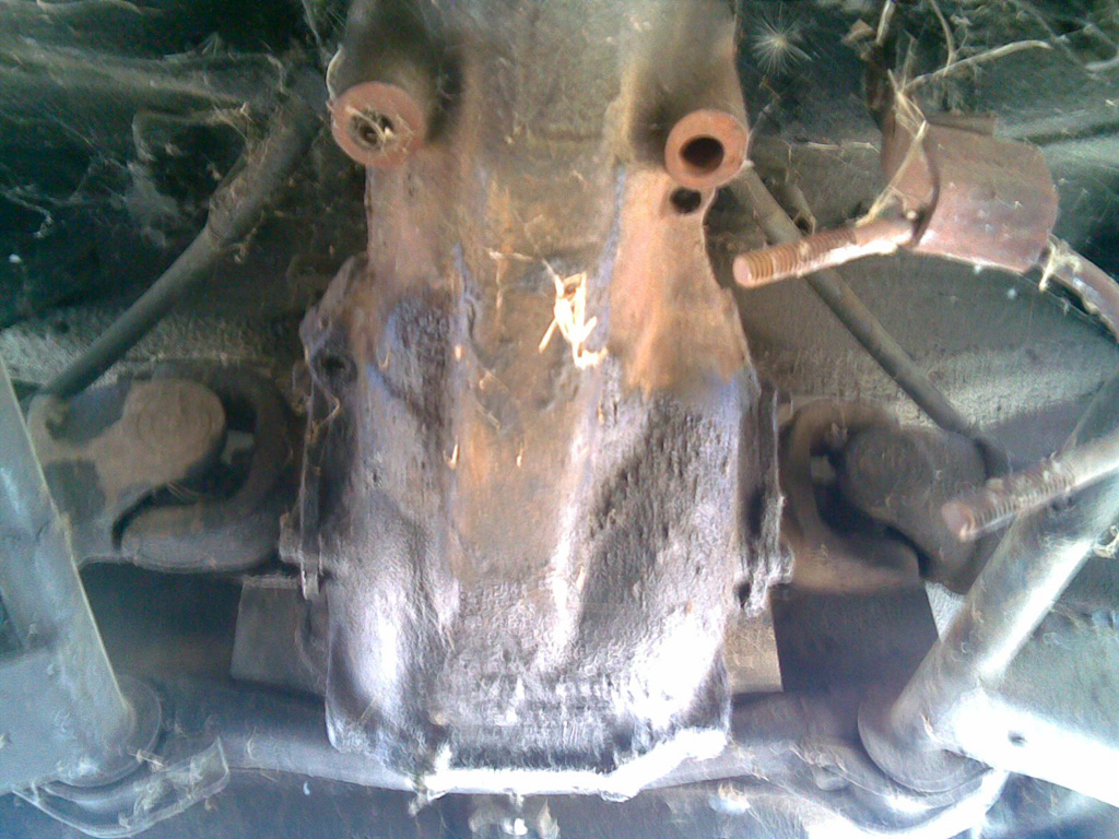

After reading around, I just realized that I've been using the wrong lingo. I went outside and took a picture of my Z's differential, and the picture shows what I want. I would like to be able to bolt my half shafts on, just like Jon said above.
So, according to the pic, does my stock 240Z differential use bolt in stub shafts, or does it use clip in stub shafts (now that I have my terminology correct).
Stock is bolt in for a 72. There were some early clip ins in the 260 and 280 I believe, but not all of them were that way, and I think they had the stub integrated into the halfshaft. Then the went back to the original style if I recall, then they went to the clip in CV shafts. The clip in CV shaft is what you have a picture of, and it was retrofitted to accept the bolt in shaft following the procedure in the thread I linked to.
There is really no benefit to one over the other in terms of function. In terms of maintenance I'd say that the clip in style is easier to deal with when you just want the halfshaft out of the way (working on the stub axle or the strut for instance). With the clip in style you can just unbolt the outside of the halfshaft from the companion flange and then use a prybar to pop the inner out of the differential and pull the whole thing out and get it out of the way quickly and easily.
