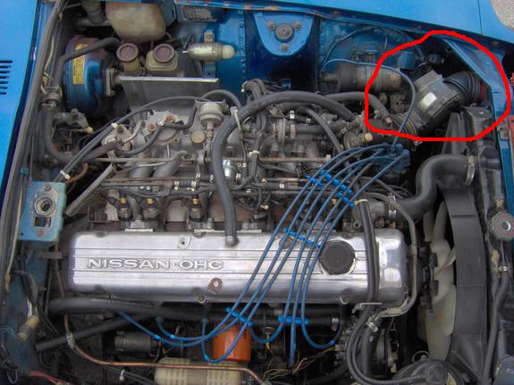

The only thing it needs besides from the above mentioned is that the little box circled in the pic below needs to be adjusted.
I don't know what it's called but if any one knows please chime in.
Owner said it gives a little whooshing sound, which I couldn't hear or notice,
when you step on the gas.
He believes it sounded like to much air.
post-13541-14150800684006_thumb.jpgP.S. pic is not of actual car, I didn't want to freak out the owner :tapemouth

Careful what you adjust on that Air Flow Meter or AFM for short. Many times it turns out not to be the problem for whatever symptoms the car is showing but tinkering with it can cause other problems. Could be just a bad rubber boot behind or in front of it.

Thaynx Blake :)
I thought that was a MAFS (Mass Air Flow Sensor) but I didn't want to open my mouth and make myself look like a jack in front of the owner :tapemouth

For the air "whooshing" sound, as Blake said
I'd check the rubber boots for the afm as it's common for them to crack which could be the cause of an air leak.
http://www.atlanticz.ca/zclub/techtips/airleaks/index.html
