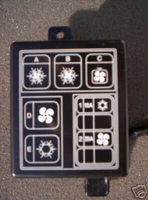

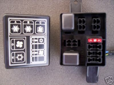

I think I am getting the idea - thank you very much for the details - I am electrically challenged. I did some Internet surfing last night and found this gem by Spal. Is this the answer (of course in addition to the recommendations that you have made)? Pictures attached.
The description follows / price is about $25.00 USD.
"This fused relay block works great to safely control your aftermarket fan(s), NOS, fuel pump(s), water pump, etc. The block includes two 12v/20a relays fused to a single 10a fuse. The block has provisions for up to 5 relays through 4 fused links. The cover protects the relays/fuses, while the wires cleanly route out the back. Eliminate multiple relays with one block unit."
IIRC, my good friend Blake sells those. Haven't seen him for a while but i don't go to as many Datsun gatherings as I once did. That picture might even be from his auction. He's excellent to do business with. He knows his Datsun stuff. He builds 3.1L strokers that work, and is a carb, efi, and turbo guru. I'd never hesitate to buy from him.
