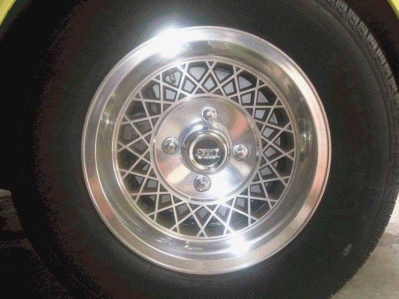

I'm torn on the wheels. Overall I like the look better than the ones on my White Z (the car that will be going away once I get everything off of it that I want)
Shown here:
but the ones on the orange car are in need of a lot of polishing. They are severaly oxidized in the spoke section and I'm not sure if a wire brush would clean that up. Someone mentioned that theirs in that style were painted in that area, which would make brake dust cleanup a bit easier. Not sure about trying to deoxidize the center without damaging the smooth surface and then just paint the inside of the spoke areas, while trying to shine the surface of them?

You would be surprized at what polishing compound and one of the Mothers Power balls will do. Look at my wheel. I had a lot of crud inside the spokes. I used some wire wheel cleaner, being careful to only spray inside the spokes. (I can't remember which brand but will look when I get home tonight)I left that on for less than a minute then hosed it off. The reason to be careful when spraying the wire wheel cleaner in the spokes and not on the flats is that it will take the shine off the alloy likety split. Even being careful I lost some of the polish and it required extra work on those areas. My spokes came clean and looked as good (well, almost as good) as the first day they were installed 36 years ago. Then I used the power ball and polish. After the power ball, I used a little elbow polish, about five minutes per wheel. Your wheel looks like it could benefit from this process.
And take the wheels off of the car to do this.
