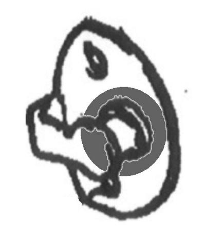

There's a plastic bushing on the round part of the door striker. In many cases, they're worn off. I don't think they can be replaced. I don't know of a good solution for this other than replacing the door striker itself. I've seen people wrap tape around it but that doesn't last long.
The part in the shaded area:
Ahhhhh, I never really looked at that thing. I'll have to check it out. Perhaps I can steal the one off the parts car I located sometime soon if that's the problem. I'll try tape and see if it works as a temporary fix. Thanks for the suggestion.
