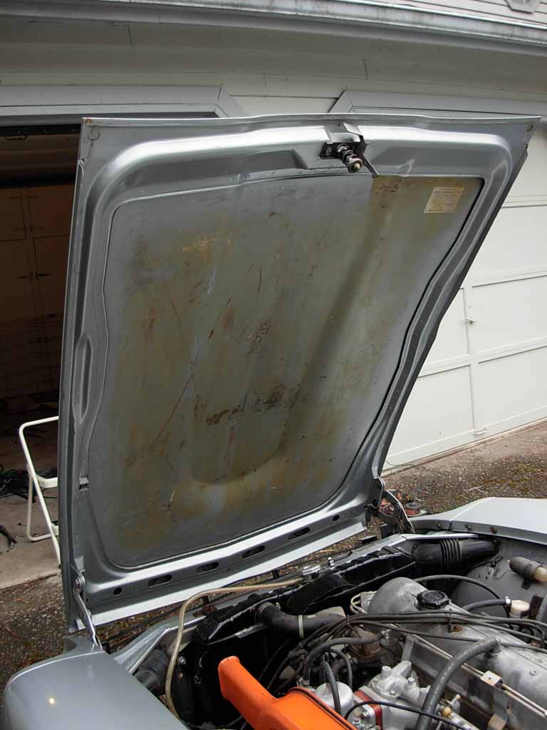

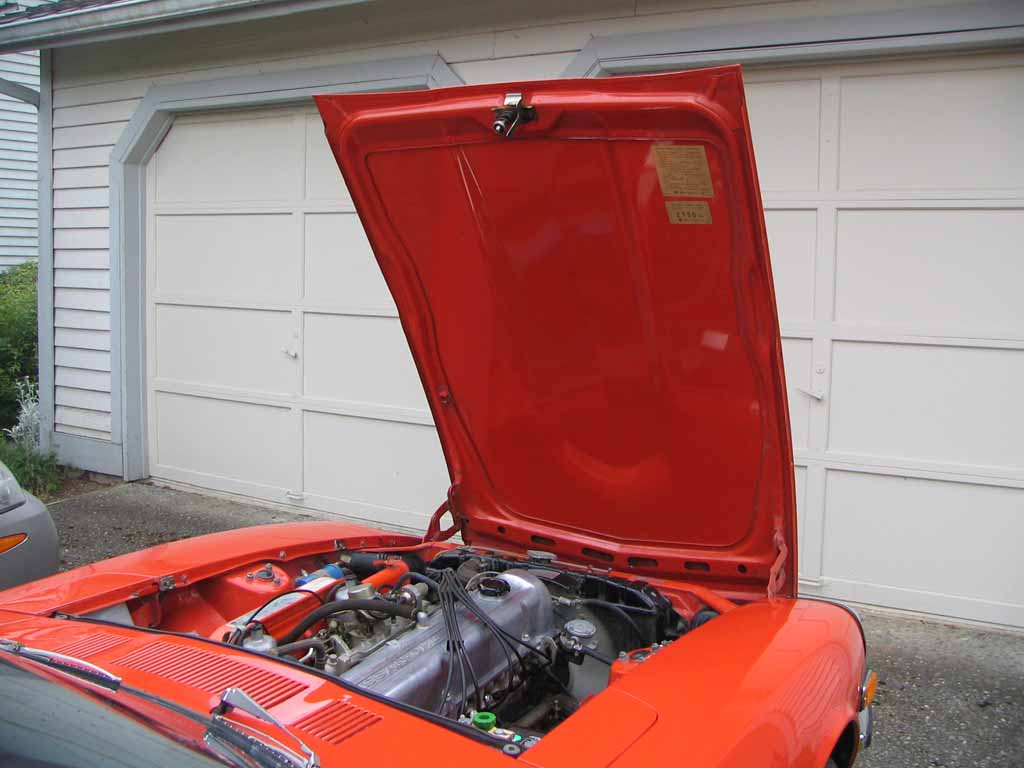

#237 looks like #26 (no corner reinforments or holes on either side of the hood release. However, my 72 does not have these holes either. Also note the difference in the hood release itself. The one on #237 is flat and the one on my 72 is angled at the top.
