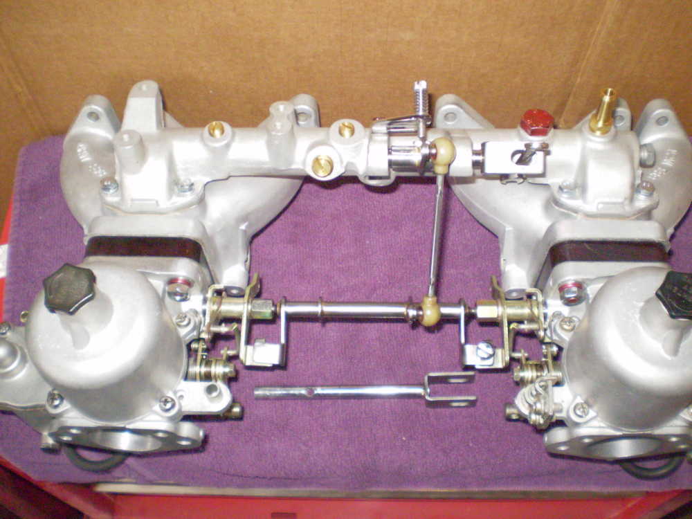

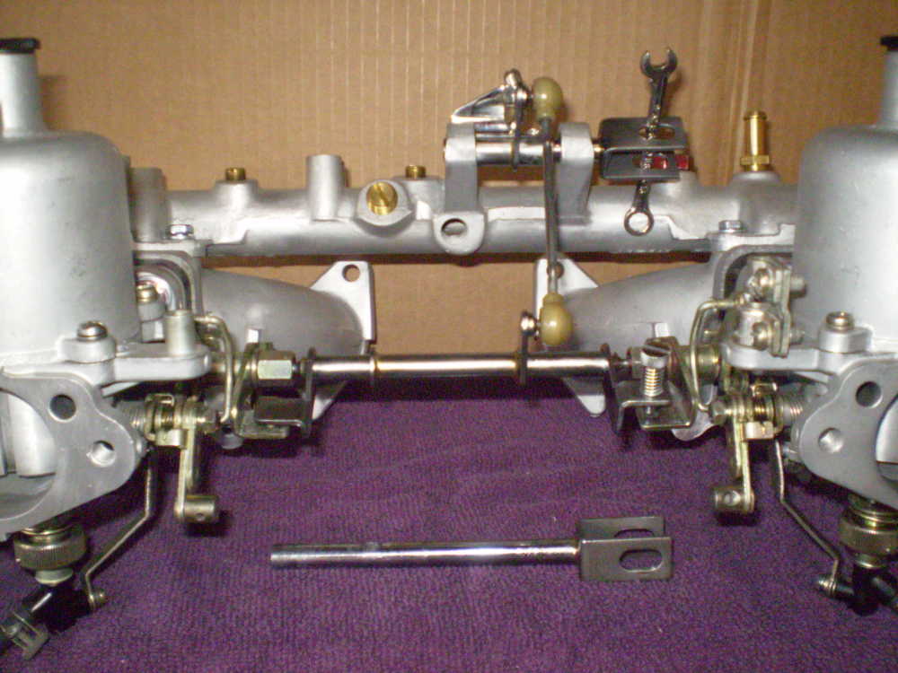

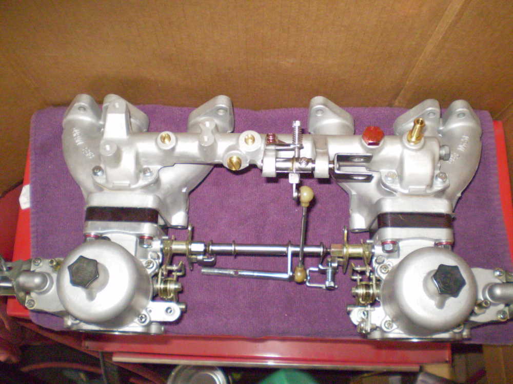

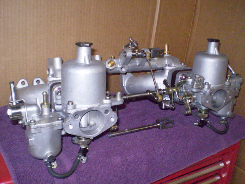

Basically, the problem was that I was using the short linkage from the round tops (second picture). The shorter linkage had two problems. First, it allowed too much axial movement. Second, it did not allow the existing maintenance screw to be used (fourth picture). Third, it did not allow the carburetor to return to full close, because the angle is incorrect.
The third problem was unacceptable. So, I fixed it by combining the round top lower linkage (which matches the carburetors) with the flat top upper linkage (which matches the balance tube). After doing this, I adjusted the threaded rod on the firewall to be the correct length with no slop, and now all three problems are fixed.
The first picture is the flat top carburetor linkage, which does not fit the round top carburetors. The third picture is an axial picture of the flat top linkage. The angle between the ball end and the screw that pushes the carburetor butterfly open appears to be greater than the linkage for the round top carburetors. The fifth picture is the round top linkage that is on the car now.
