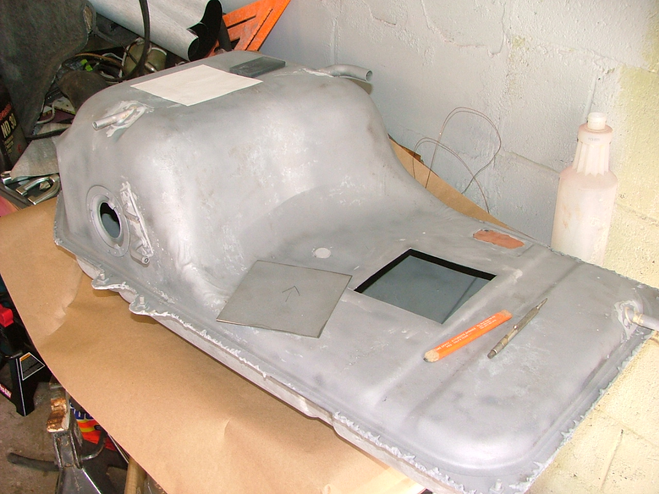

Maybe we should all post pics of our tanks when out of the car? I saw a tank out of a 280 (don't know what year) and it was very different. Didn't think it would fit in a 240. Think it was a later variety tank as mentioned above. Did see a 260 tank out once and it looked slightly larger in the thin section that fits under the tire well.
Fitting a 240 tank into a 240 has never been fun for me. I can't imagine the frustration of trying to fit something which may not.
Still, it might get someone out of a bind if they knew that the tanks crossed over as 280master says. Have you known anyone that has made a successful swap to the 240? This would be good news for some.
Pic of my 2/71 tank attached.
https://www.classiczcars.com/topic/25252-gas-tank/#findComment-219008
