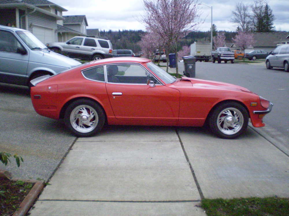

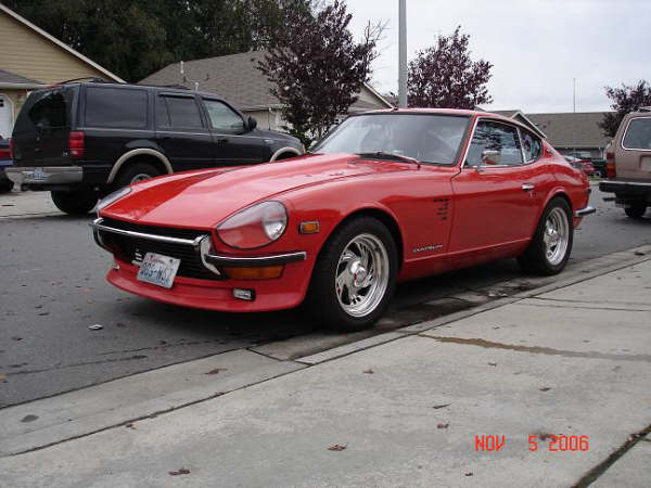

For 14x6 wheels (which is what I have on my red 240Z) I'd go with either 195/70-14 or 215/60-14. Either should fit fine, unless the wheel has more reverse offset than is standard, in which case the 215/60 might barely touch the lower corner of the front valance when turning.

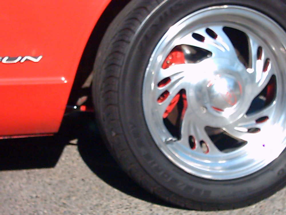

I totally understand keeping with the 14" wheels but if you ever decide to upgrade and upsize, I think you'll love the feel, fill, and ride of the 16" wheels on 50 series tires.
I have 225/50R16's
They fill the wheel well beautifully and give the Z a nice stance.They are stiff enough to hold tight around corners and soft enough to give a decent ride without discomfort of a low profile tire..
But maybe thats just me,
Dave.
