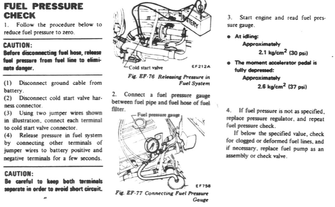

EFI doesn't vapor lock. It operates at a high enough pressure to push fuel, vapor and anything else through the sytem. Except for sediment, rust, crud, etc. I would use fuel injection rated line for any line in an EFI sytem. If the fuel damper is bad, the sound of the fuel pump will be abnormally loud. Improper fuel pressure can cause any or all of these: difficult starting, high or rough idle, misfiring, lack of power, hesisitation/stumble, surging, dieseling, and poor fuel economy. Here's a scan from the FSM:
