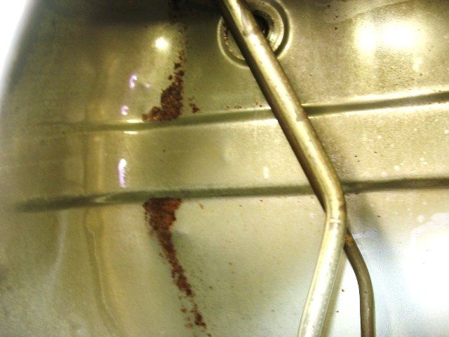

Thanks . The rust is not as bad as I thought it would be ,but I started the day with the intention of just checking the screen in the fuel pump. Before I knew it the tank was in my lap.

Sorry Jackhammer, I should have been more specific .My second post was to thank you for your reply and I have emailed Por with a few questions. In the later post I was referring to the how to link in 280z1975's post and the reminder from EScalon to blow out the intake tube . And Jim after reading your page I think I'll add the cost of the radiator shop and Por-15 vs. Renu and see how close it is. I'll email some pictures to Renu and see if I can get a quote. Around here I think they still use MTBE which I have to see if that causes problems with any of the products. Not sure if it's alcohol based but it is very toxic to ground water. Thanks for responses and I will post back with the cost comparison between DIY and Renu .

For that amount of rust, Renu may be overkill. However, the process does claim to fully coat inside and out and to restore otherwise shot tanks. It is a franchise service, so dealer performance may vary.

Enrique is right about the small amount of rust. If it were me, with that little tank rust I'd just get some hirsh tank acid and let it do the work on nixing the rust. Sure, in a few years it will be back but who knows what can happen in a few years? (Wrecked, sold etc)

As far as POR clogging the filter, just blow through that vent once or twice while its sitting there--POR before it dries is paint-like, so it easily comes off. I strongly suggest looking at my POR tech article. It's still running awesome, and I had no issues with clogging lines (although I didn't have the same screen). Just make sure you blow through a few times, and that rust you show will be no issue with a POR15 application.
