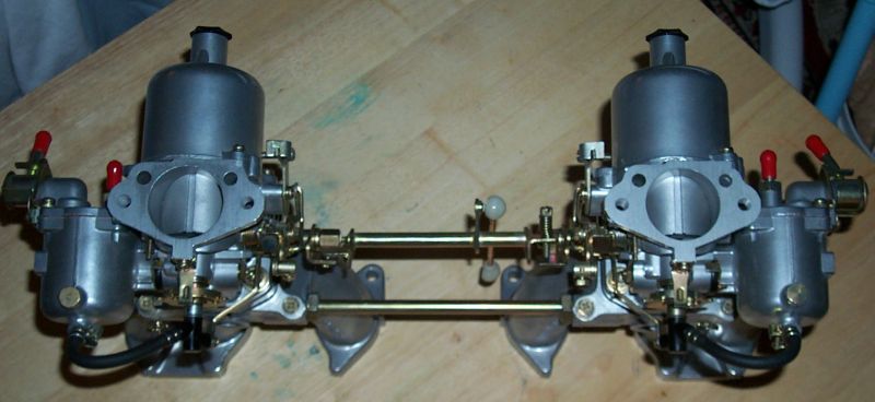

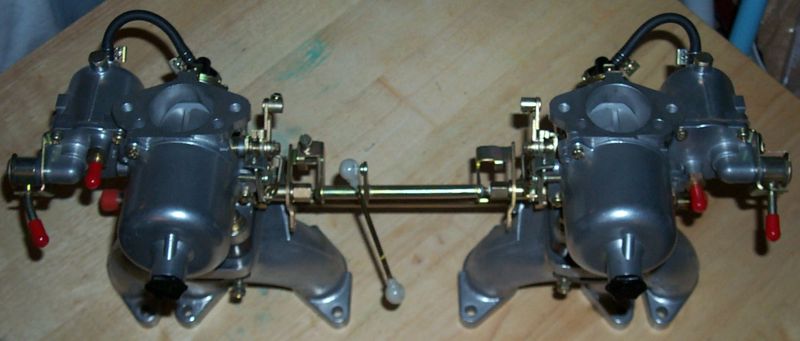

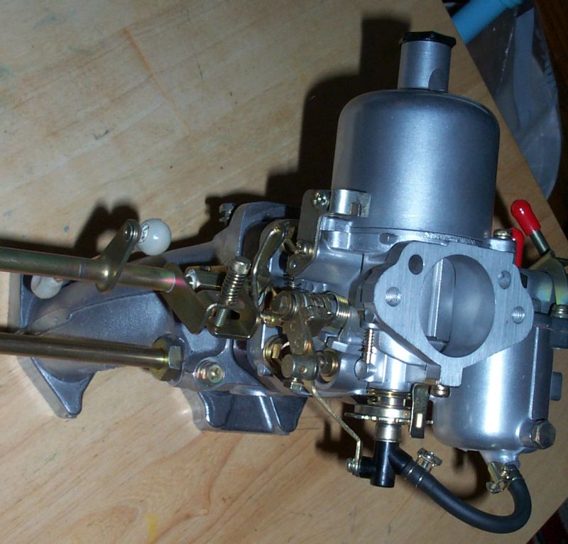

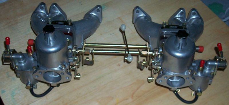

Best answer-clean and box up the complete Flattop assy(heatshield, manifolds, Balance tube and carbs) and get a complete assy of three screws from ZTherapy(Bruce has a twisted sense of humor-run with it!) bolt 'em on, tune them as directed, and find what you have no clue was missing in your car! I had a '73 with flat tops that I thought was well tuned until I swapped to three screws...night and day difference, never would have thought if I hadn't been persuaded. Best thing to do to a '73 with the original drivetrain.
Here is most of what it looks like!
