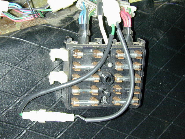

Here you go.
First pic shows the in-line fuse holder AND the fuse holder HOLDER on the side of the fuse box.
Second pic shows more detail. In the case of this vehicle the fuse holder had already been marked by the original installer.
Third pic shows the connection for the Fog Lamps. (Not a part of this thread, but where you would insert a switch to activate power to the fog lamp connectors at the front of the car.)

Hi E. / everyone:
That first picture looks like the installer was an Authorized Dealer using the Factory supplied parts. The little clips on the side of the fuse block were also included in the Factory 73 Modifications Plus Program package here in the US. I don't know if the Factory Actually installed the same parts later in the production year ot not - they easily could have..
It is nice that one is clipped to the side of the fuse block - but I haven't seen too many of them done that way (even by the dealers mechanics taking short cuts and leaving the fuse holder next to the other two in the wiring harness behind the dash.
Usually- if you find an in-line fuse holder - that wasn't installed by the Dealer - the installers didn't have the same color coded wires to use.. or the aftermarket fuse holder simply had black wires on it..
