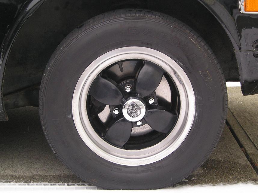

Hey , got to love the libra's . Mine are painted black currently , but they are to be painted graphite soon to be close to the taillight finisher's color . All 4 of mine are in excellent shape except for the pitting on the center caps . These are shelby vipers and I feel lucky to own such a set that seem to be very desirable .
My teen son's think they are way small at 14 x 5.5 , but I wouldn't have it any other way !
Your AR's will look awesome any way you finish them .
