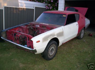

well, i have managed to snap up the 240K GT that was recently on ebay.. It is a 72 model (complied in australia 1/73) and it is build number 280! i know it wasn't probably the smartest buy.. considering my other project.. but i just can't resist sometimes!
unfortunately the car was a bit of an ongoing "project" and most of the bits of the car have been lost including the original engine, gearbox, bonnet, rear light panel, dash cluster, seats.. it was destined to have some form of V8 in it, but i am looking to fix her up and try and bring her back to a somewhat original look. the car is moslty stripped at the moment, so i am looking at fixing the remaining rust, get her painted again, and then put her all back together using some of the other parts i have lying around.

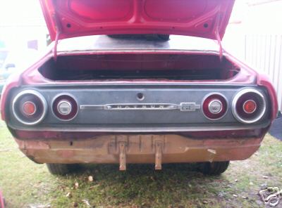

oh, and I forgot about those taillights. They are not original GT parts, they are JDM items.
The JDM lights do NOT comply with the Australian ADR's applicable at the time of manufacture and could not be fitted by Nissan.

I will need to see what the car is missing on saturday afternoon when i pick it up, but i know that all the instrumentation is missing (including the bezel), i didn't check when i looked at it, but i assume the dash is the original one just recovered.
Unofrtunately it looks like the car was half pulled apart a number of years ago, then it has moved from place to place.. and some of the important parts have gone walkabout. The guy has obviously been picking up bits and pieces as he went.. but i am not confident he knew exactly what he was looking for
do you happen to have a picture of the rear beaver panel? the one that "comes" with the car has a different datsun badge (almost like what i remember the sedan one to be) to what i have seen before, and it had a GL badge on it, so i presume it is not the original.

Kent, there were two "early" rear Datsun badges as far as I'm aware. One has black text (never actually seen one on a car) and the other has white. Are you sure the badge you have on this isn't just a later model badge? Got a picture of it?
