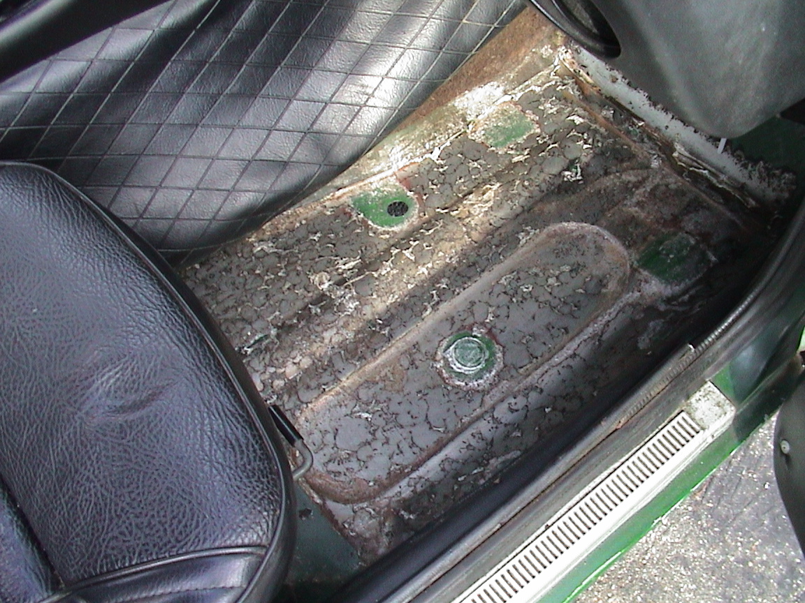

Thanks bunches for taking the time! My Hubby spent the past 2 days ripping out the Tar Mats (chisel/hammer/muscle) and it was enlightening! Same as before the Tar Mat was taken up, little discoloration, but also little rust so I'm thinking they're one in the same. All I did was to dilute CLR with 50% water and a rag to just rug things down, and followed up some with a wire brush, and it all looks good/silver and is LOUD! Now that the tar mat is gone, it just sounds a bit louder, though still GOOD! Very Z-like!
Will follow up with pictures soon (maybe). Want to get things done, wrap it up and put her out to bid!

Looked at the pictures on your update, if you look at the lines of rust that you DID have beneath the floor mat you can see how those would be hidden and could potentially have been much worse.
To remove the last of the tar mat, you can use plain old Mineral Spirits or Acetone and that will give you a completely clean and smooth floor which will allow you to paint and re-apply the tar-mat.

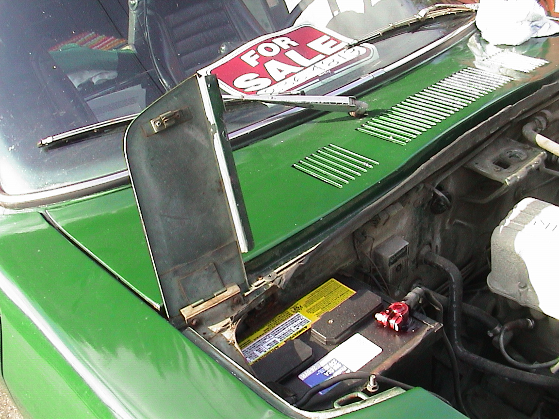

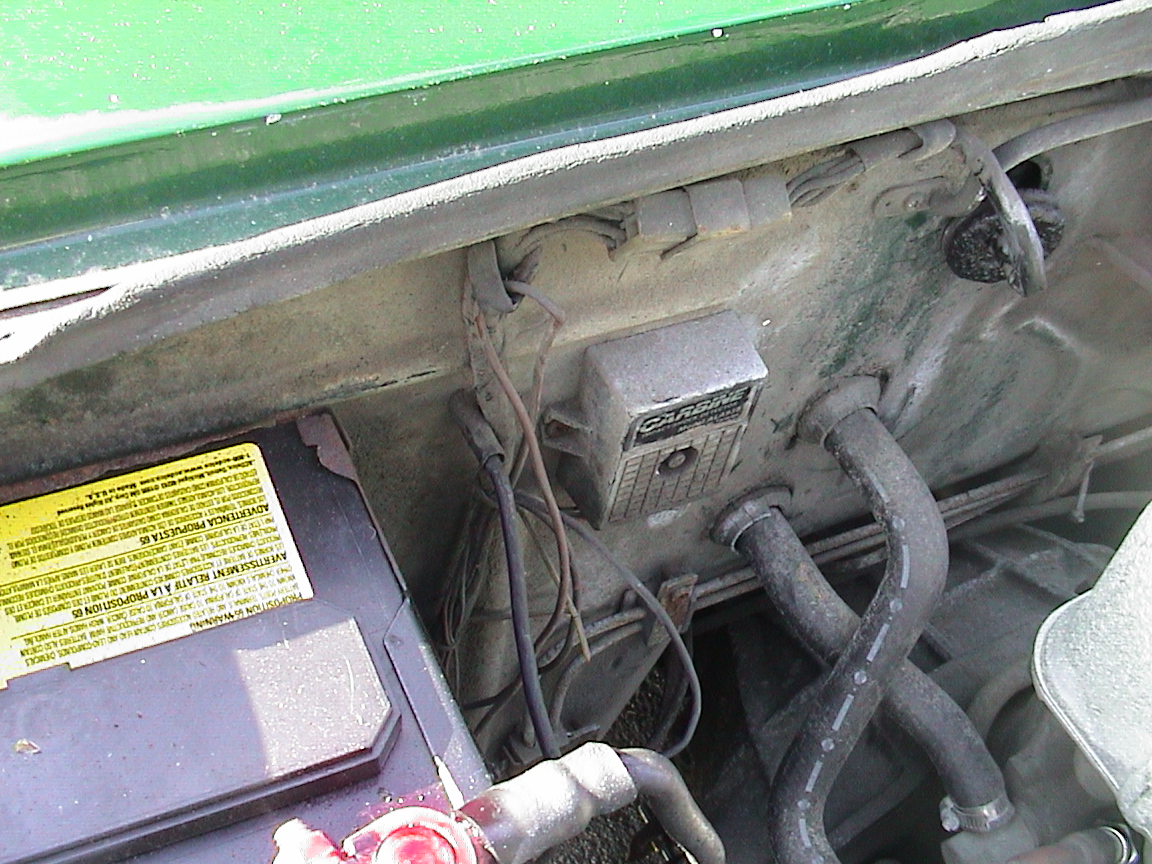

SORRY! the picture of the rust under the battery didn't show, so trying again. The weatherproofing (or rubber gaskets at the top of the hood when you open her up is old and crunchy and likely how/why any water would have gotten in and collected). I have photos of those, and looks kinda easy to replace; though not sure. Anyway, in the interim, covered her up to keep her dry! Much needed rain should come tomorrow.
