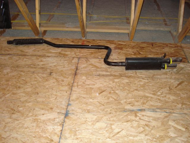

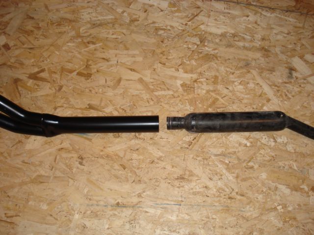

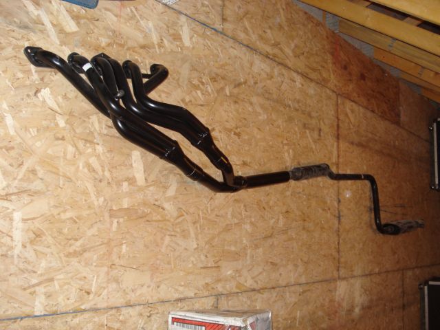

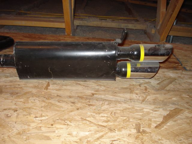

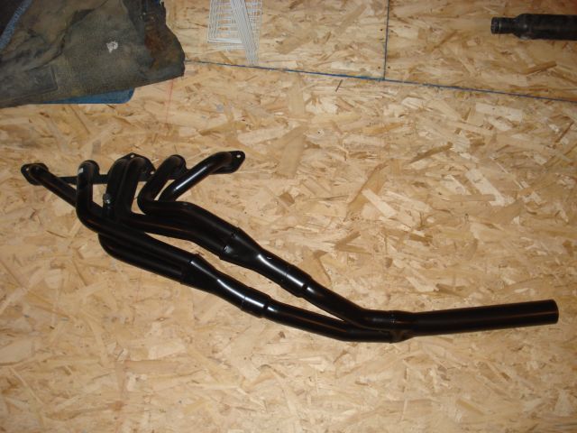

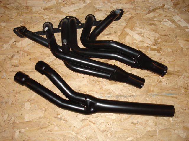

In 2005 I purchased a Monza exhaust system for my '73. My Z had the factory exhaust manifold at the time. The Monza exhaust, which is contructed with 2" pipe, was easy to install and sounded great. The twin tips are chrome and each one has a yellow ring close to the muffler end.
A month or so later I purchased a Monza header from Victoria British (now Black Dragon). I ordered the header in their catalog that was listed for the 70-76 240-280. It is a 6-into-2 design. The individual runners have a 2" diameter and the collectors have a 2-1/2" diameter. The output end of the collector pipe also has a 2-1/2" diameter and will NOT mate up with the exhaust, which is 2", without a reducer. I've attached a few pics of the header, collector pipe and exhaust that are now collecting dust in the attic of my shop (waiting for future Z car projects!). Keep in mind this was back in 2005. Maybe Monza now has a 2" header, or a 2-1/2" exhaust for complete header/exhaust system.
