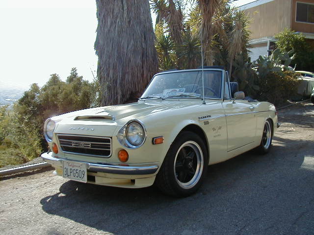

I have a 1970 SRL (2000) Roadster and I love it.
Parts are no worst than 240 restoration parts. The R-16 (1600) motor was far more plentiful than the U-20, so engine parts are still avialible. You'll find great vendors for the roadsters who are making and developing reproduction parts to keep us running for some tme to come.
If you get the roadster, join the roadster mailing list. you'll find lots of info at http://www.311s.org/
Be sure to register you car at that site as well.

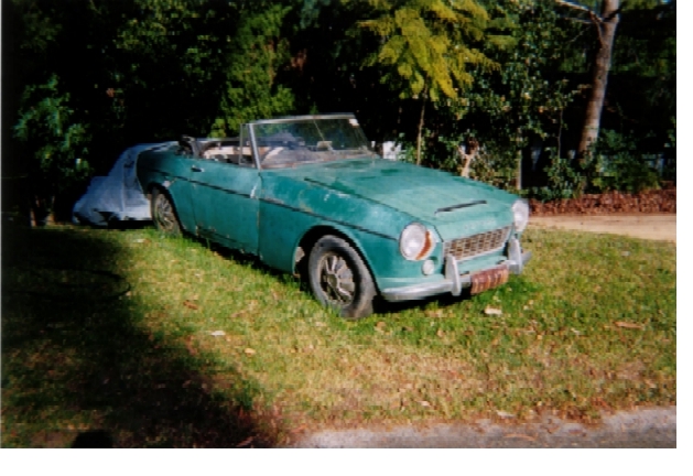

I have a 69 model Sports 2000 which I race, here in Australia you are looking at around $5K AUD for a hack and up to $15K for a good clean car so $900 US sounds rediculously cheap to us!.
Parts over here are almost non existant, particularly body panels so restorations are hugely expensive.

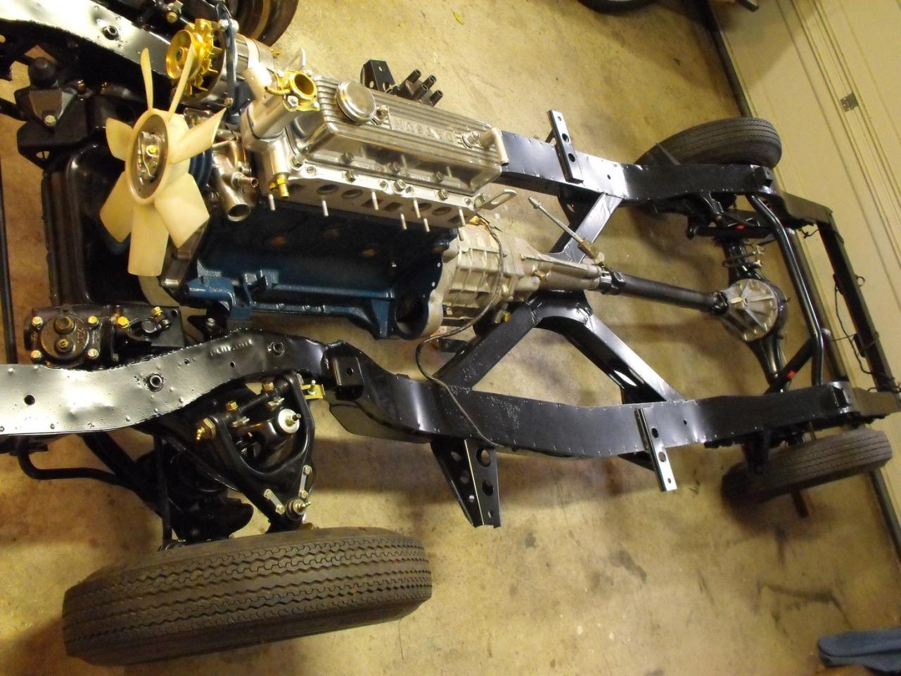

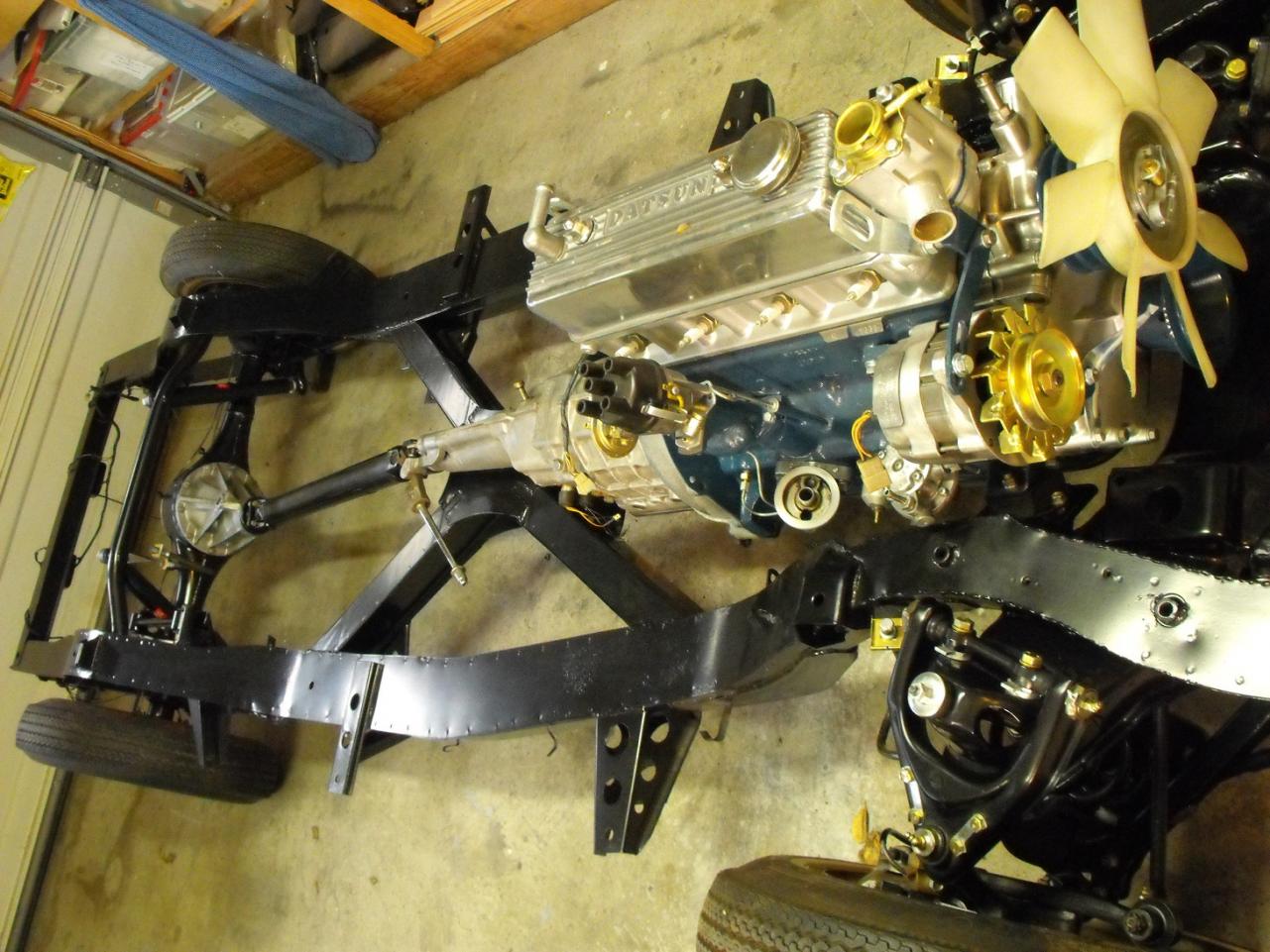

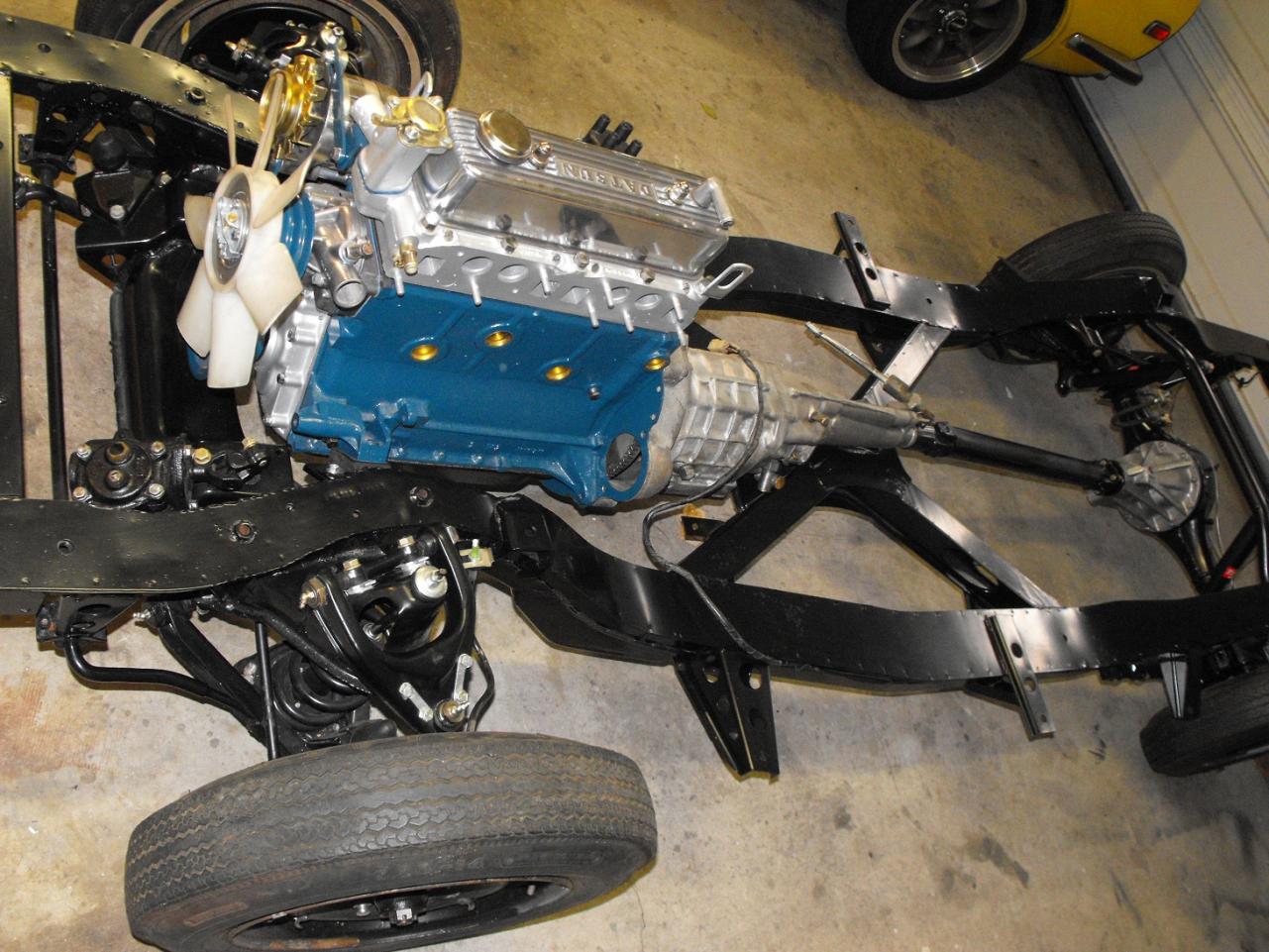

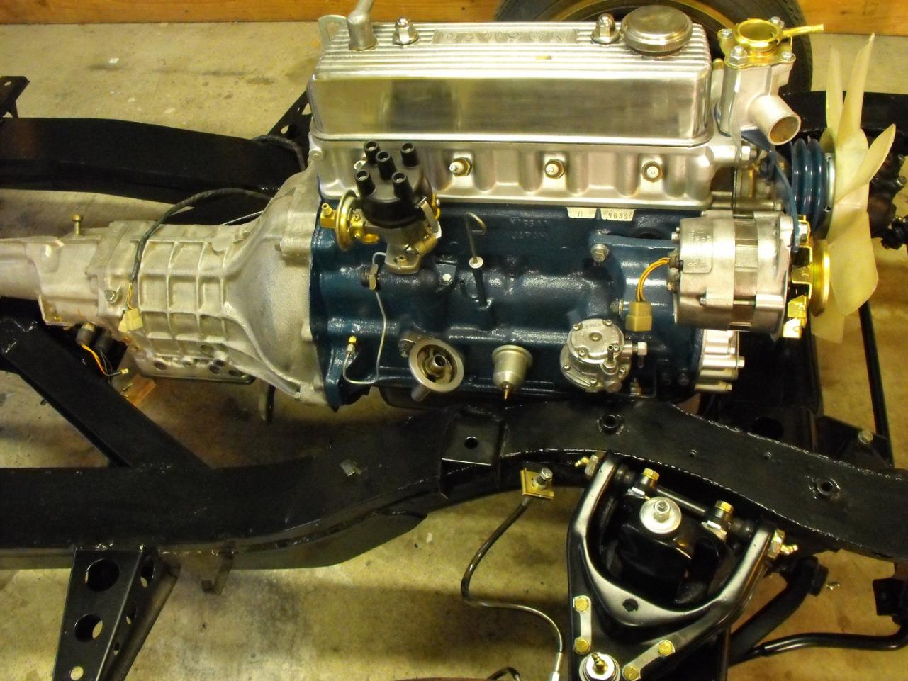

I put the motor in my roadster today. Had to make room on the engine stand for my Z motor. Anyway, just thought I'd post some pics of the Roadster. The resto is slow going. Doing too many house projects for the boss.
Probably need some new tires here too.
At first I wondered why a 10 year old thread would be revived, but those pictures are choice material!!!
I have one of each, a low windshield 67 1600 and a High Windshield 68 2000 (currently in work), and I can see that you've put in some excellent time to getting things right.
One thing I note, the block is missing the Coolant Drain Valve (Left side towards the back, just a plug of some sort), and even though it may seem inadequate, it is convenient when you need it.
Unfortunately, once you have everything put back together, the engine bay is extremely tight to work in, and you'll only be able to get a wrench into that area of the block if you remove the splash panel on the left inner fender support.
