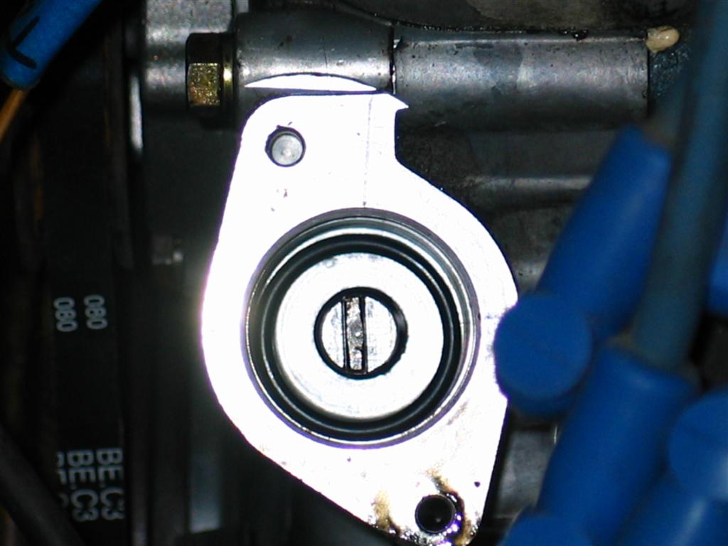

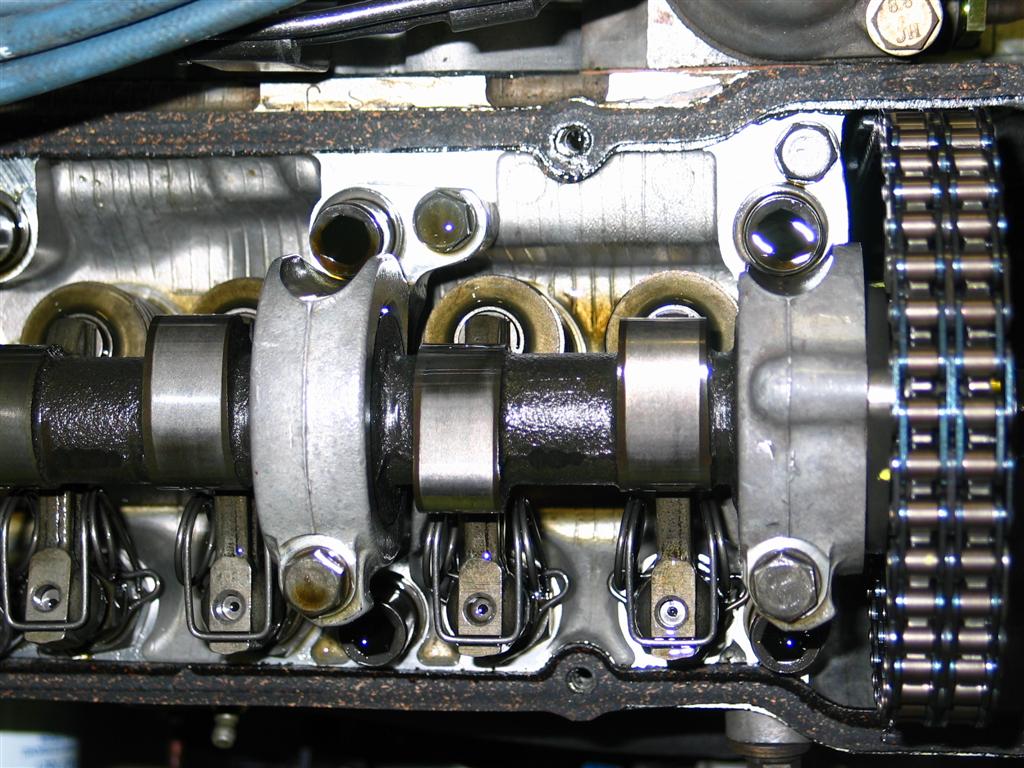

So, I still have a problem. With the distributor fully advanced it fires up. I got to thinking about when I repositioned the drive gear when reinstalling the oil pump/distributor...was I off? It seems likely given how this came about, so I checked the distributor drive gear tang after manually setting the camshaft to TDC at #1 (picture #3)
I'd like to say that's at the 11:25 position, (pic #1 and 2) but I have my doubts...Is it closer to 11:45? 12:00? Maybe it's off by one groove--that would cause these kind of symptoms yes?...any thoughts? In looking at the pics I think my reference line drawn for 12:00 may be slightly off.

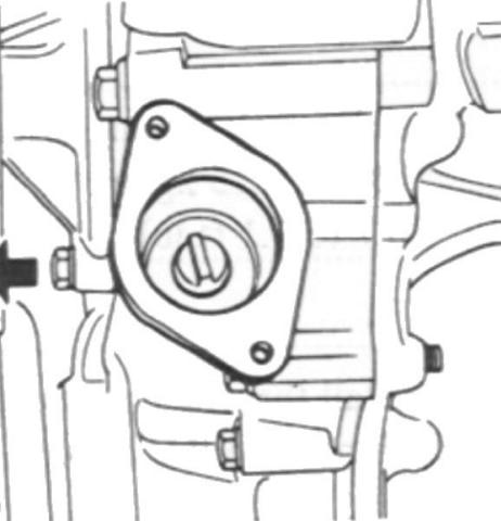

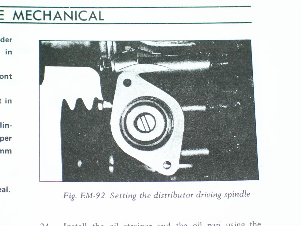

The timing is still max advance, making think the distributor drive shaft is off a tooth, but I would REALLY like some other's input into my prior post---any pics of properly positioned tangs? It looks sorta like that image in the FSM, but some exerienced opinions would be helpful....

I was always under the impression that 12:00 was pointing at the radiator. Picture 1 and 2 are pointing at 3 or 9 O'clock. but not seeing the rotor on the dizzy throws me off.

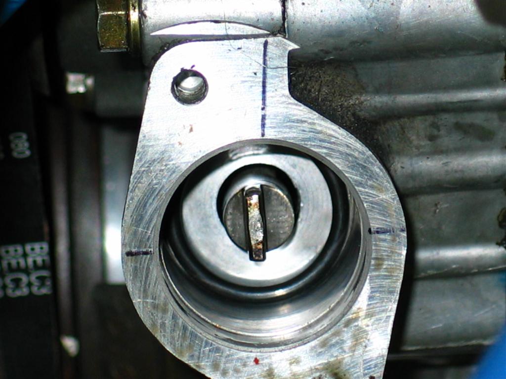

The FSM places 12:00 toward the cylinder head and block, and on p. EM-31 states the drive spindle should be oriented so its top is "located in the 11:25 am position, at this time, the smaller bowshape will be placed in the front."
I was able to finally do a side-by-side comparison of the drive gear tang orientation, and it appears off (see pics). Tried checking the timing with a timing light, but my old one was non-functional and I finally got a new one today. As a result, the timing marks are off...pretty significantly

The tang must be in the proper location for the timing marks to be of any use. If not, when you 'advance' the distributor it's still not in time with the engine. In other words, where your distributor drive is now, even when you turn the dist as far as it will go, you run out of adjustment before it reaches the point at which the engine will run properly with no possible further adjustment. Definately get that squared away before you deal with the carbs.
Good day XRAY,.... I've been working on these L28 over 12 years now, and the distributor shaft is supposed to be at 11:25, we've gotten these engines breathing through triple Mikunis at 270 BHP and 225 Lb Ft, 19 deg of ign timing, with zero detonation........
