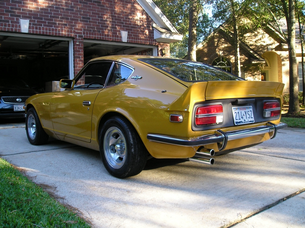

I've retained the old "mufflers" and installed stackers out the left side. See comparative photos. The sound is still the same, but it now looks better and more complete.

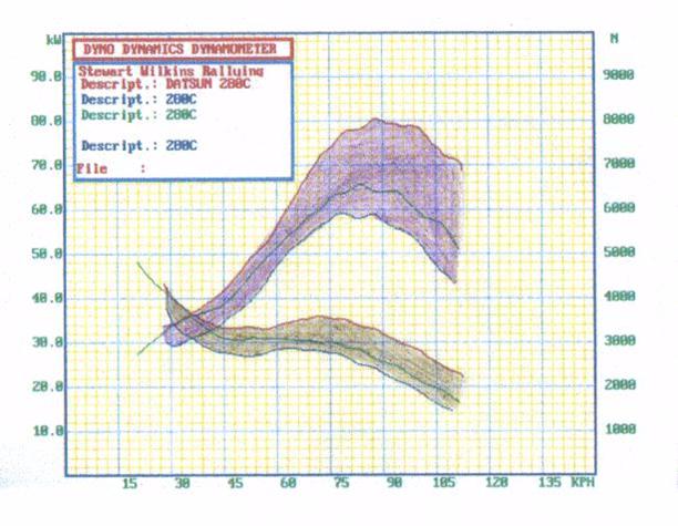

A few years ago I began a series of modifications to my L28S to improve its performance. Along the way, I decided to dyno each modification to see what effect my modifications had on rear wheel horsepower. One of the first things I did was to replace the standard 2 barrel carburettor with a 4 barrel Holley. Then I replaced the entire exhaust system and installed a set of headers and a 2.5 inch pipe including two mufflers because I wanted the exhaust note to be quiet but free flowing.
I've included the dyno graph that shows these two mods. If you look carefully in the shaded part, there is a line that represents the addition of the Holley carb. Not a huge improvement as you can see. This showed me that the engine was consuming as much air as it could but something was holding it back from producing more power. The other line is the result from changing the exhaust. To say that a performance exhaust is worth very little in extra power on what is, essentially a stock motor, rubbish. Maybe it's got something to do with the majority of guys running the twin carb setup, being of a dual plane arrangement as compared to my single plane Holley setup that might end up producing different results for different engines. All I can say is that the 'wow' factor, in this case, was huge.
At the time, I hadn't really known about the twice pipes exhaust setups. Once I found out about them, I did some research of my own and read Morrisons and Smiths book titled 'Scientific Design Of Exhaust and Intake Systems' where experiments by these fellows concluded that the twice pipes are indeed the best setup for inline engines with a firing order of 153624. When it comes time for replacing my exhaust, I'm going to run a similar design on my L28. It's just that I didn't know about it at that time otherwise my car would have this system on it now.
Cheers,
Mark
Ozconnection, thanks for sharing the dyno sheet. From you description above, I'm guessing that the bottom curve was taken with the 2 barrel carb (not sure what that is - we didn't get any 2 barrel carbs here in the US) and stock exhaust, and the top is with the holley 4 barrel and upgraded exhaust. I see you gained about 35%, but when I convert to HP I see that you had ~ 80 whp before, and ~105 whp after. Many others have posted that a stock L28 (with twin SUs or FI) will put down ~120 whp. I'm not trying to "rain on your parade", but unless I've missed something, your original configuration had some serious issues and was not representative of a properly tuned stock engine.
Nissan didn't create all L28's equal. The 280C was probably rated at less power than the L28 fitted to the 280Z & ZX. I say probably because I'm not sure on the figures for that car, but the L24 fitted to the C110 Skyline was around 20HP less than the same L24 fitted to the 240Z.The C110 also used a downdraft 2 barrel carbie.
I would guess that the heavier cars engines were tuned for more torque at the expense of maximum power.
Edit: Yes good point Arne. 80 kilowatts = 107 HP
