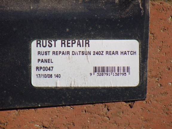

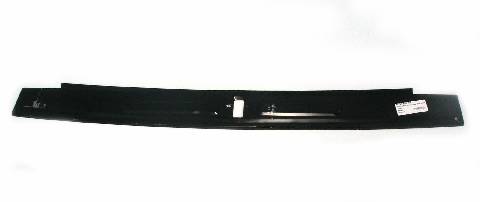

I have some pics. of the repair panel but this Forum is playing silly cows with attachments at the moment, I'll try later:rolleyes:

New rear panels are available from MSA.

you can get that rear hatch piece from several parts suppliers for $110.00
you should be able to get it welded on for less than $400
I bought the rear end from a 280z and had a body shop cut out the lower hatch piece you are talking about. Cut out the rusted hatch of my 240 and weld in the new piece for $400.
The 280z rear end cost me $100
