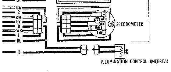

You won't see anything labeled 'dash lights' or anything like that. On a wiring diagram, you would only see the lines representing the wires going to the gauges, connected to a little lightbulb symbol inside the gauge. One of the wires/lines (grn-wht on a 280Z) goes back to the light switch connector, and then the switch itself, and the other wire/line (red-blu) goes through the dimmer control to ground.Get a wiring diagram for your year & model to see how yours goes.
Here is an example of the diagram for the dimmer control on a 280Z. The B wire from the dimmer control goes to ground. The other (RL) comes from the lights.

Like Tom said, look for a 2 wire plug that has a black wire and a red with a blue stripe wire. That's the plug ya want. Get another dimmer switch and try that. If it works with the new one, the old one was bad.

The, FSM shows green with blue tracer from the fuse block to the combination switch ,your light switch on the steering column. When the lights are turned on power feeds to the dash lights on a green with white tracer to the bulbs.Hope this helps Rick
That's the same as my 280Z. After the g/w goes to the gauges, the r/l wire goes to the dimmer control, then a black wire to ground.
So for cebu, connecting the r/l wire for the dimmer direct to the chassis should get him some lights. If not, then he's got a broken circuit somewhere.
