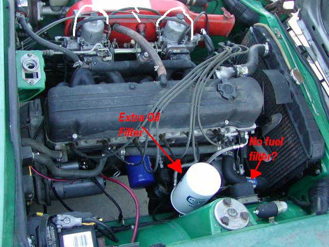

The only problem is I cant find the fuel filter on my Z its been moved I believe because looking at other Zs its not on the wall near the engine bay lamp. Also I have 2 oil filters which I find very strange one is the original filter (85A) the other is a huge after market with a gauge attached .
Heres a fairly old picture, but the filters are the same right now I have blue NGK plugs and Wires.

Your first problem is in the picture you posted..... The breather hoses for the float bowls are connected to each other. I corrected it with white lines in the photo below... Your carbs CANNOT BREATHE with the float bowls connected to each other.
The second problem is "Where the hell is your fuel line?" Follow the fuel lines from the carbs. They are supposed to go to a fuel rail that wraps around the valve cover and over to the fuel filter where you pointed out "is missing"
Find the fuel lines and get a filter on there.
Take off those hoses on the carb and air cleaner box and put them from the float bowls into the airbox via the nipples.
get back to us when that's done and the fuel problem is corrected. Can't help any more till that's done.

OK. so the picture from the first post (#1) shows the fuel line going to the frame rail on the drivers side, follow that and see if you can find a filter and then change it.
If you can't find one. Install one filter per fuel line before they get to the carbs and you should be safe till the next problem arrises.

PS you can almost see how the float bowl tubes should be in the picture below....
