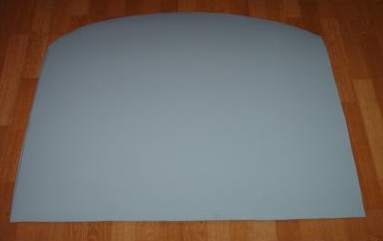

Latest update - I've been in touch with a bodyman in Salem, OR who has re-skinned several S30 roofs. He knows what to do, where to cut, and how to get it all right at the end. His plan is to cut at the top of the windshield opening, the top of the rear hatch opening, and just inboard of the drip rails. The attached picture shows pretty much what he does.
This is absolutly the ONLY way you ever want to replace the roof panel on a 240-Z. Take it to that man, he knows what he's doing.

My thoughts exactly, Carl. It made so much sense when he explained it to me, compared to what other people were talking about. I plan to call to discuss his schedule tomorrow.
