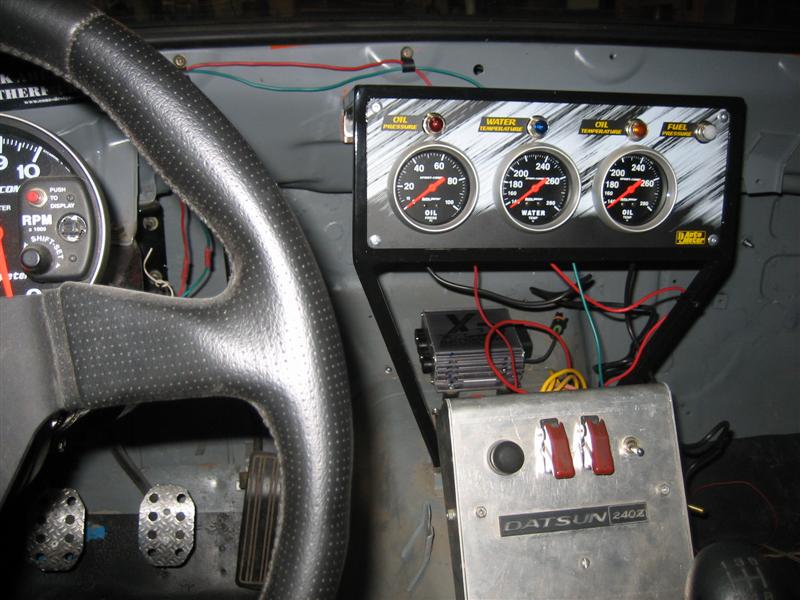

I'm finally getting a "real" motor for the FP car so the stock Datsun oil/temp gauge is going to have to go. It has served me well for 7 years now, it's about time for some accuracy.
So, I've got an Autometer mechanical gauge panel to install and I'm looking for pics and or recommendations from your installations to give me some ideas. My current setup is about as basic as can be so I'll have to build something to mount them on. No dash bar on the rollcage but I can probably add one if that's the easiest way. I do like to keep things simple as you can tell from the pics.
Wiring and plumbing I understand, only thing left is the mounting. I've got passable fabrication skills and tools (check my fuel cell install) and can probably get (bribe?) my old buddy tholt to help out if it's something I can't handle. :-)

If you had a clean slate, what would you do?

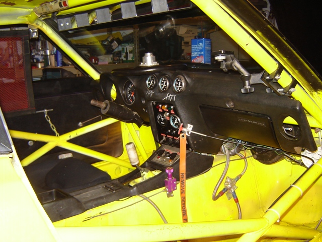

Attached shows my dash setup integrated with the cage. Makes it pretty simply to modify as needed. Looks like you would have no problems fabricating a similar setup based on the good quality of work on your fuel cell. Hope this gives you some ideas.
