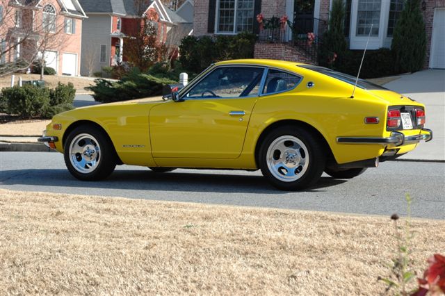

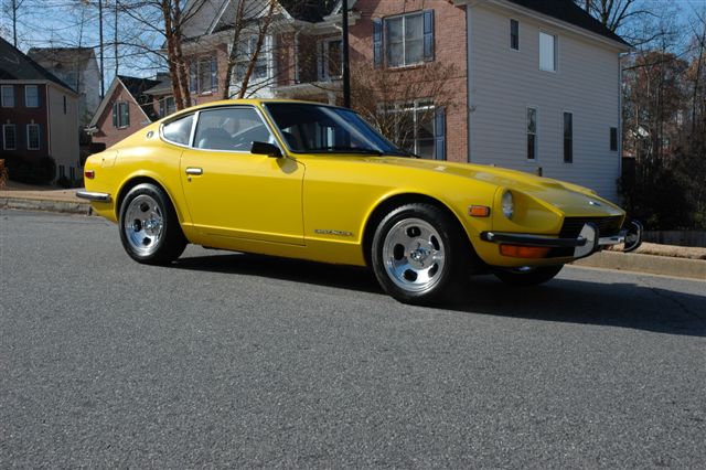

Do you have a side-view pic of your car so I can get a feel for how the 15" wheels / tires look?
Thanks!
JP
There are more in my gallery, but here are a couple shots with old 195/60/15 tires (before I replaced with 195/65/15):
