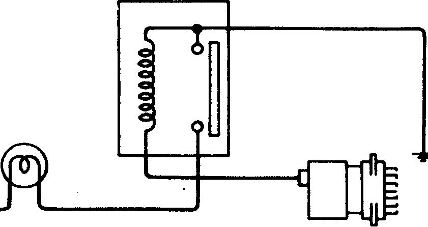

This is the diagram of the relay from page BE-35 of the 1977 FSM. The OEM relay is a SPST normally closed using only a 3 terminal connector. The terminal to ground is share by one leg of the coil and one leg of the lamp circuit. The second terminal is for the yellow wire from the alternator and the third terminal is for the green w/yellow stripe wire from the brake warning lamp.
If I remember correctly, you should be able to take a Bosch relay and wire terminal 85 to the yellow and terminal 86 to ground to power the relay coil. Terminal 30 is wired to the green w/yellow stripe. Terminal 87a should be normally closed and terminal 87 is normally open. You want to wire terminal 87a to ground and ternminal 87 is not used.
A Bosch relay socket can be used to wire into the factory harness. If you don't want to butcher up the harness you can wire the relay socket into a male 3 terminal connector if you can find one and plug the new relay setup into the factory female connector.
