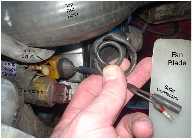

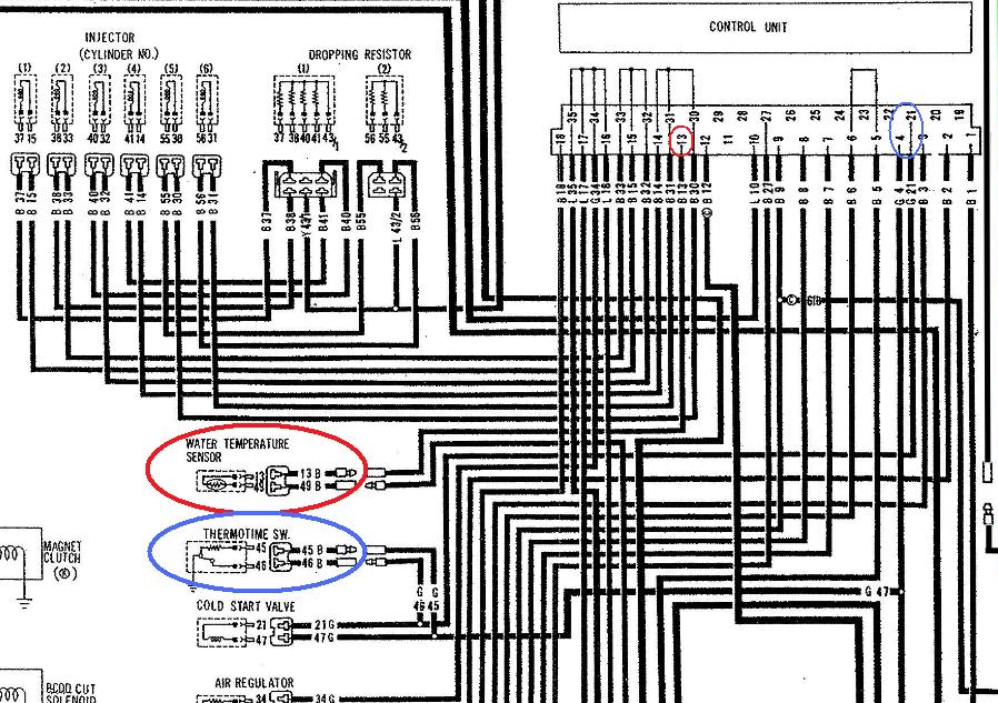

Your question 1: No they are not the same. Page 19 & 49 refer to the Thermotime temp sensor (for the Cold Start System circuit) and page 79 is a test for the temp. sensor for the ECU.
Page 64 has a goed overview of the two temperature circuits. (Pin 13 and Pin 21 on the ECU connector)
If you want to test the Thermotime circuit. It is on page 98 Test #3 - (3).
Poor connections are a big problem with these cars and very important in these old (analoge) systems. I replaced my connectors with aftermarket on the Injectors (for easy testing) and OEM on the Temp.sensors. See attachments

Here is a photo from AtlanticZ and a snapshot of the wiring for the 280Z 1978. Hope thats the right diagram.
Good luck with hunting it down.
