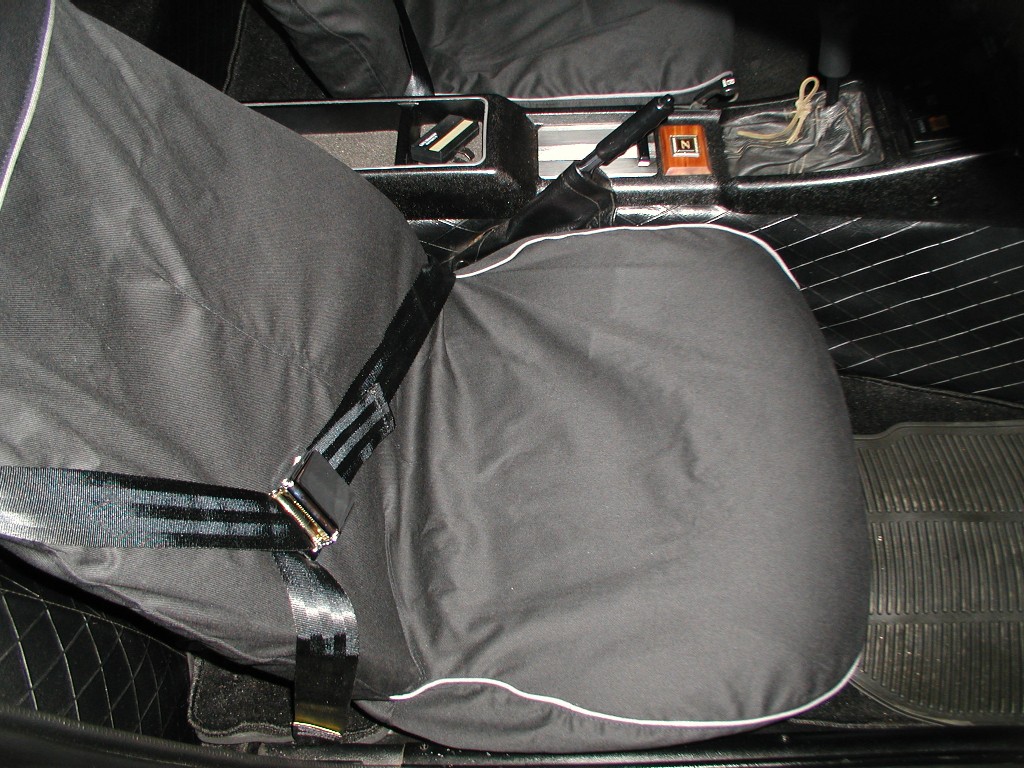

Photos 000 & 001 are of the completed Installation. Seat covers are MSA's washable Black covers.

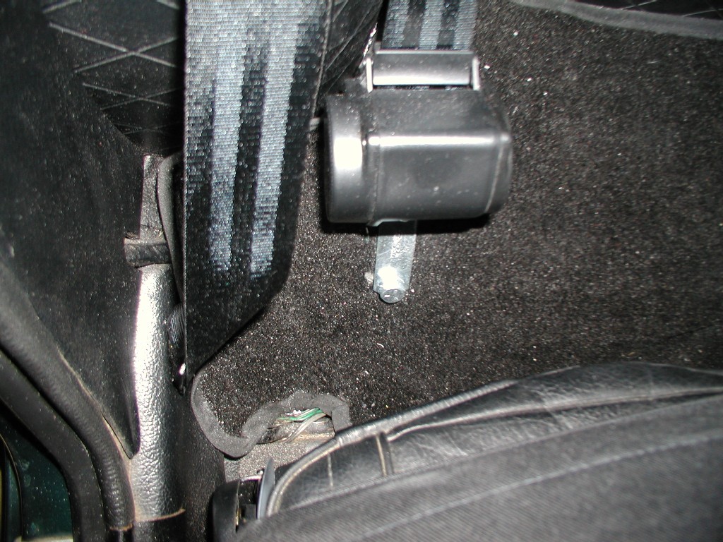

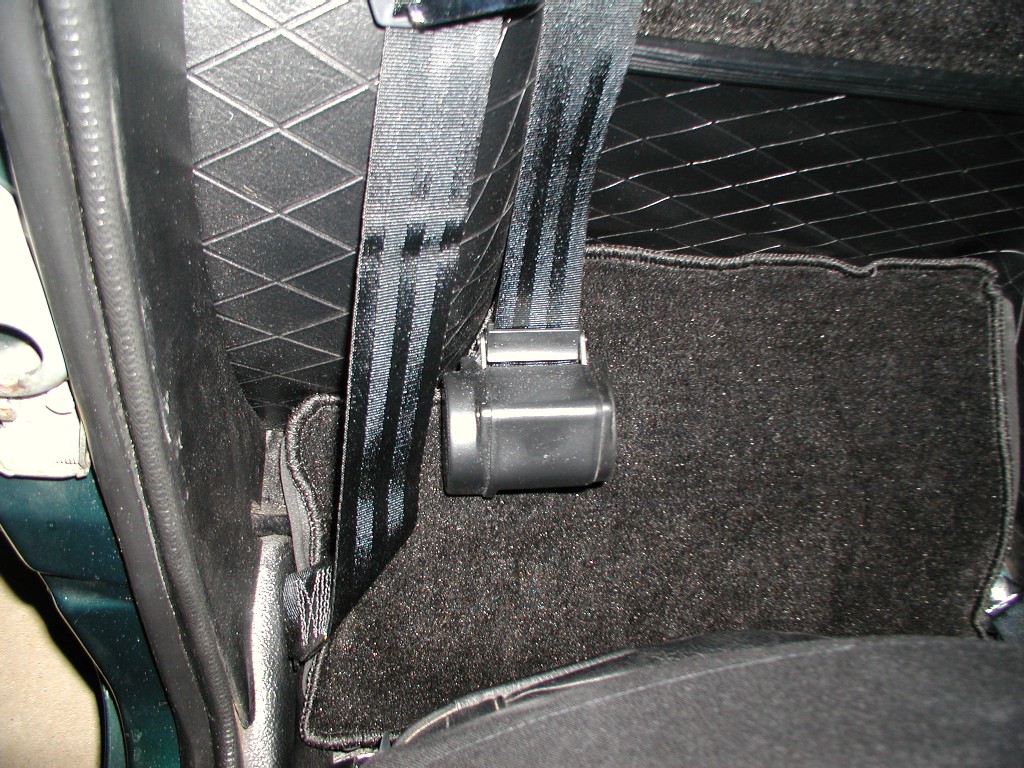

Photo 002 is a view of the retractable unit base and the shoulder harness clamp. The carpet is slit under the retractable unit to cover the mounting hardware.

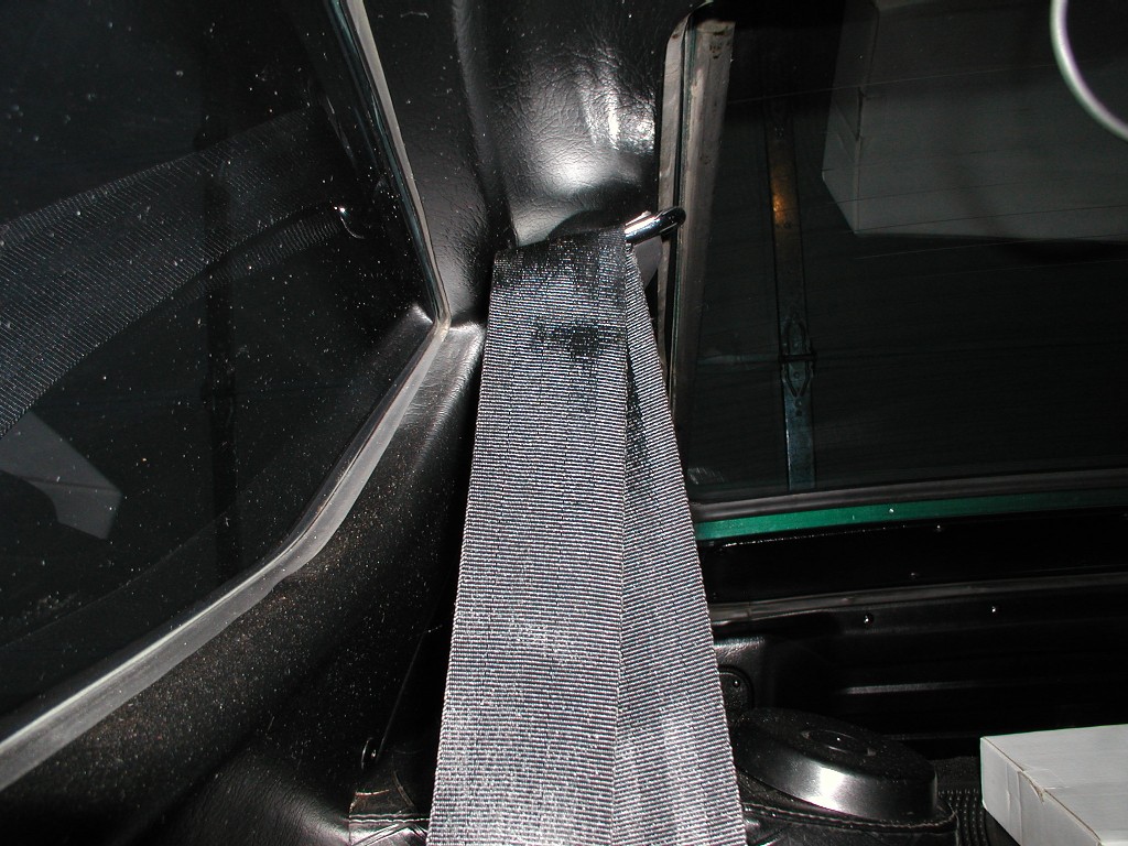

Photo 003 is a view of the Y Clamp attached to the roof. It must face forward so the shoulder strap can be pulled and retract easily.

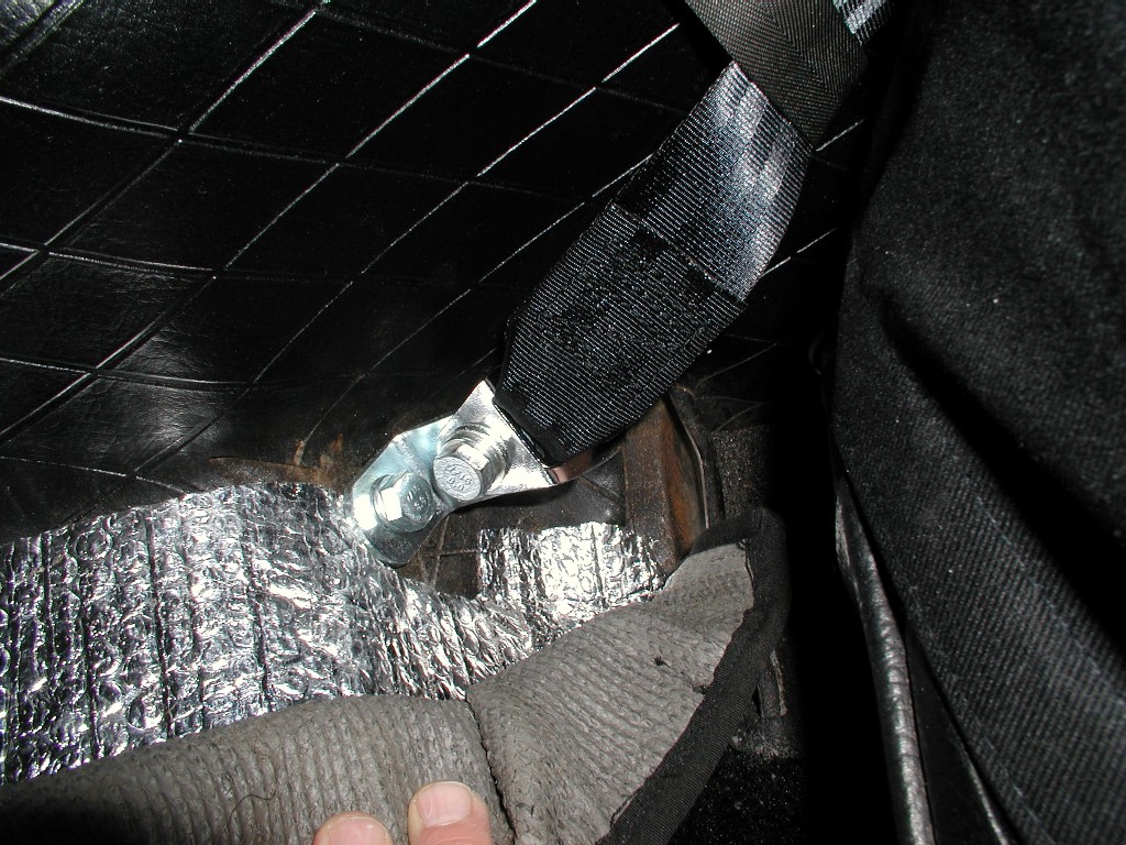

Photo 004 is a view with my Carpet removed. I have old carpet down with sound insulation under it, so I did cut a hole to allow the 3" bracket to be attched to the existing hole in the floorboard.

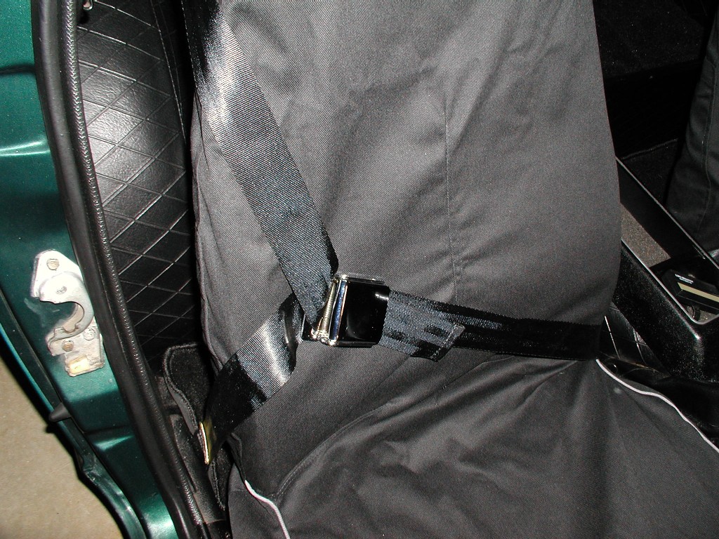

Photo 005 is a view of the lapbelt attachment. I used the L bracket that came with the MSA kit so it cleanly fits and is upright nicely against the transmission housing.
