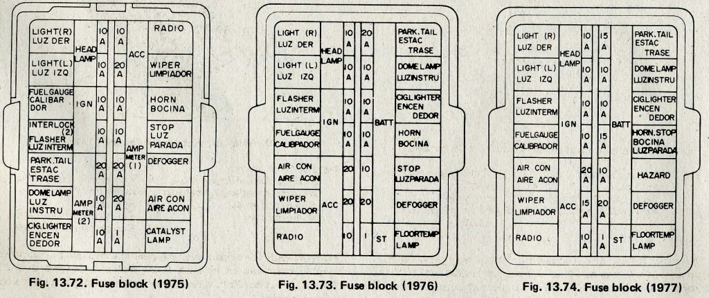

I just finished retrofitting my 76 280z with SU's and it starts and runs great! Only problem is that my gauges don't work. The turn signals also don't work although the hazard switch does. I did some reading and searching through the forum and found some very helpful information but I just can't seem to find the problem. I looked at the fuses and three spots aren't getting current. I attached two pics with yellow boxes around the locations on the box that have no current. I have tried tracing those wires and can't find what they go to. If anyone could help me identify these wires and/or tell me what I could try I would appreciate it. I'm trying to get the manual that everyone around here is talking about but money is kinda tight right now (college student). Again any help would be greatly appreciated.

if your 76 is anything like the 77 my bf has, the two top ones are for the right and left headlight. he found a picture the other day that is not in front of me at the moment so i forget which one is for which headlight. the one on the bottom i can check for you. in fact, i'll see if i can find the link for the picture so you can take a look at it. just hold tight till then.

Here is the fuse map from the '77 FSM (I assume it's the same).

The one on the bottom right is for the charge lamp in the voltmeter. Connections to check are behind the glove box at the main junction block and the alternator. As for wiring diagrams the most kickass one I've found is at, http://www.colorwiringdiagrams.com/, also known as Prospero's Garage. Every do it yourselfer with a classic Z should own one. $17 bucks plus shippng. You can't even go to the movies for that! Just remember they use the U.S. Postal service, so if you have a P.O.Box have them ship to that. Believe me I know. I had wait for it to be returned to sender before I got them my box #, but it was sure worth the wait. I wish you luck. Dan
