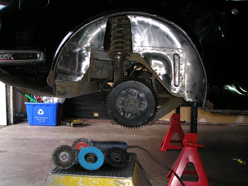

Evening , the scraping has started big time , heat gun, scrapers and solvents and I'm making headway ,however once I have the majority of the heavy tar coating off I'm left with the factory undercoat , the light brown colored thin stuff . My question is, the undercoating is still adhered very well to the inner fender wells and my intention is to recoat the wells after all the scraping is complete . I want to seal first with something like por-15 or the Eastwood equivalent , then re-do with a gravel guard or bed liner type of protection . I did a search on this and came up with some answers , but I'm looking for more input so i can be on the right track . Btw , it looks to me like the inners are in awesome shape considering this is a 71-Z , wouldn't you agree .

Lip of fender looks to be in great shape , the dog leg portion has had previous repair and from all appearances they did a good job there . what I'm looking most for is can I seal right over the solid under coat with a paint type sealer of some sort ?

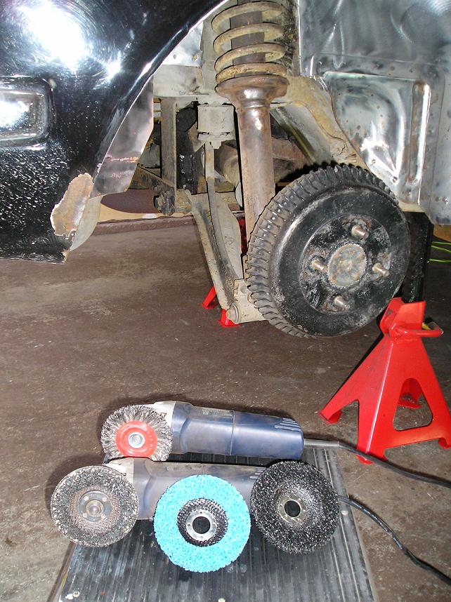

Good advice Steve , I happened across another method that completely took me to bare metal in minutes . My angle grinder with a super coarse prep wheel was the ticket , then a bit of acetone to finish , no scraping at all was needed . Advice needed though , I'm following directions and have searched the P-15 site , What I need to know from you all is how soon should I top coat my second coat of P-15 with the chassis coat black that I will be applying . My shop is heated to 70 d , paints are same temp and I'm brushing as this is a inner fender well application ? Thanxz for everyones continued support in this great site .
