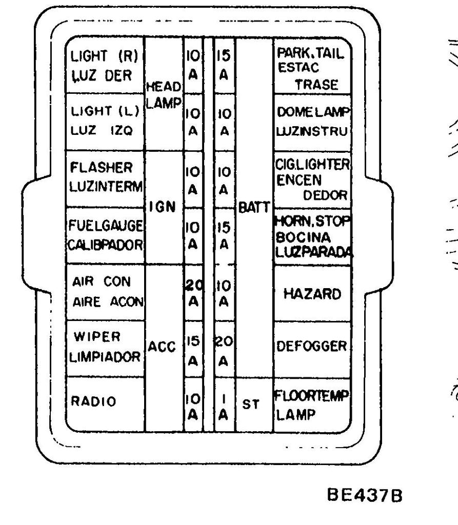

Also, another tidbit of info: There are 14 fuses in a 280Z fusebox, 2 columns of 7 rows. On the 1st column, 4th row, the fuse continues to blow VIOLENTLY which is linked to the gauge circuit. Any reason for this?

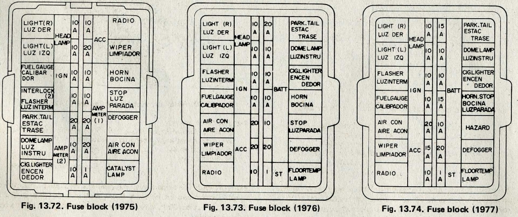

Here are a couple of pics courtesy of other members, (Nissanman and Big Oak if I recall properly) of the fuse box covers for the 280. Note that though you may have one "year" of car, yours may actually be a previous or later year...that's where you need to be careful.
Hope this will help.
Take note that the 3rd & 4th fuses on the left side switch between the 75 and 76 years.

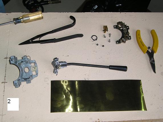

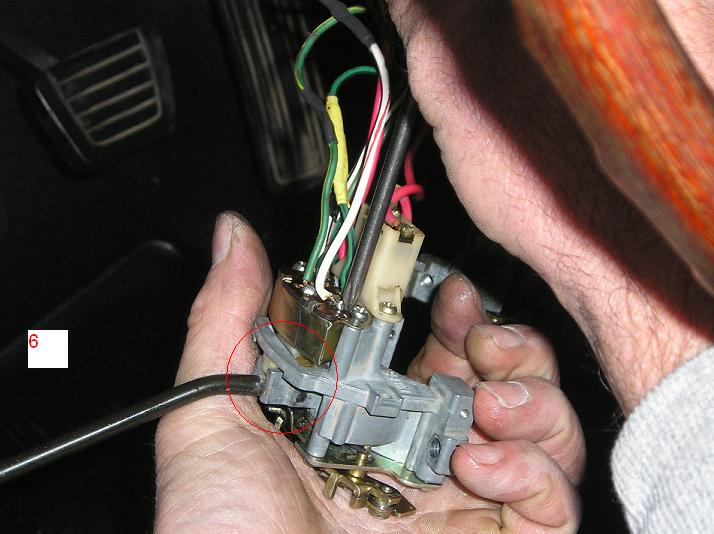

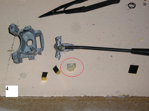

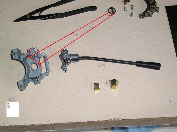

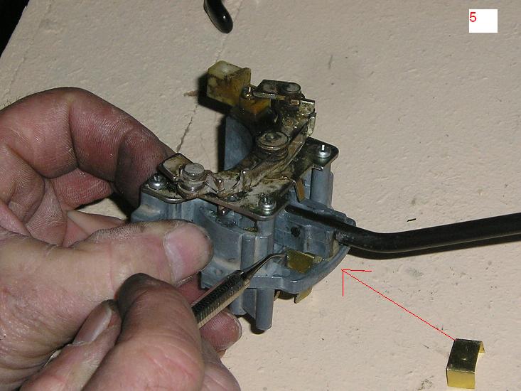

I fixed my signal problem when i bought my Z this past summer by making a brass shim that engages the switch with more pushing pressure so as to engage the rocker arms in the turn switch . I will send another post with pic's later in the day as I'm just on my way out . This is a great fix , I'll type to you later , after 4pm pacific time . have a good day
Chris
Excellent. Looking forward to that. I think these problems are fairly common with these Z's so I hope that SOMETHING will work haha.
I pulled the stereo head out a few minutes ago but I haven't had a chance to see if that helped me or not. Odds are that will help the gauges NONE. haha
here she goes , the process is pretty simple . Buy some brass shim material , mine came in small sheets from ultra thin to thick . Obviously your mechanical so take apart the two switches , turn sig and high\low beam to access the turn sig lever assey and remove from steering column . turn assey over , remove split ring and carefully turn over and pull apart . don't lose the two bearings . The plastic piece that slides in the groove is worn out . Make shims to fit , I used two very thin , first one on top , second on bottom and lubed assey with die-electric grease to aid movement . If it feels ok , fit it back together and hopefully the shim will engage the rocker assey in the sig switch . I used die -grease in the switch as well applied carefully with a dental pic . I put it all back together and just like magic it worked as hoped . A miracle I'd say .forgot to mention , when satisfied with fit I crazy glued the two shims to plastic assey to hold in place .worked like a charm . I hope the pics help
Good luck, sorry for the delay, finally got the attachments to post.
Chris

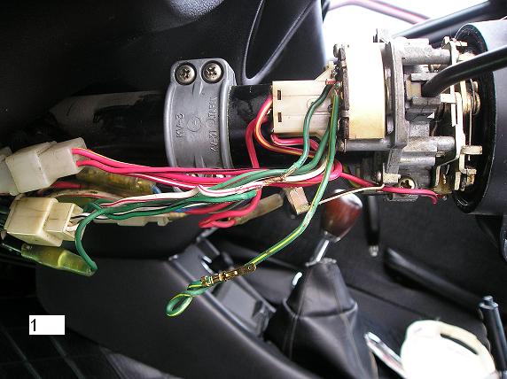

On our Z cars, most of the time the turn signals stop working is because of the Hazard switch not working/making a solid connection. Hazards will work but the turn signals will not. All of the turn signal lights and hazard light run right through the harzard switch. There is a quick fix to this. I will probly get flaming feed back on this but this is what my machanic did.
On the turn signal plug there are 3 wires. 2 white, 1 green. Take the green wire from the turn plug and run a jumper wire to the main 12v imput of the hazard switch. This will bypass the hazard switch(Because its NLA) and even after repairing does not always work. Now the only bad part of this is your turn signals will work when the key is in the off possition.
Did you punch holes through those brass shims to allow the plastic shaft into the plastic slider?
I'm looking at the pictures and looking at my switch and I'm trying to make sense of it.
What I tried to do was I shimmed the spring with a cut off finishing nail ( it lengthened the spring's effective distance by about a millimeter ) and had hoped the extra pressure for the ball, along with cleaning the contacts on the V plate inside the curved chamber would make a better contact.
I reinstalled it like this and it did not work still, but I don't know if this would have helped anything.
Should I still try the brass shim method?

Your problem is the hazard switch. Run a hot wire to the green wire on your turn siganl plug and if they work then your switch is good along with the fuze so that would be a hazard switch that is bad. Even when the hazard switch is bad the hazard lights will work. I know I just spent 2 weeks tracing the same problem. I rebuilt the turn signal switch had the FSM wiring Diagrams and test just about any way you could think of. Look at this PDF I am about to post.
